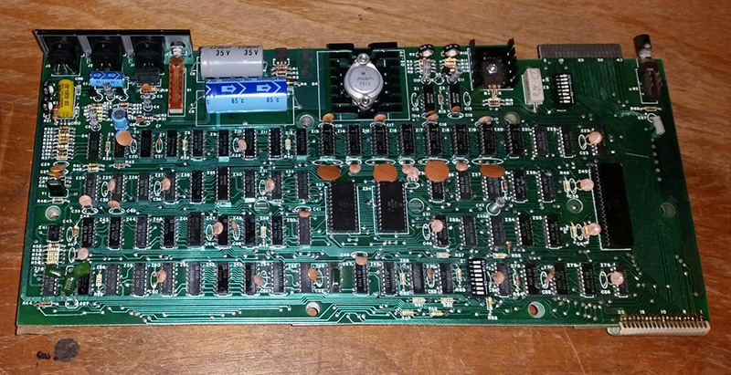

Postby tezza on Sun Feb 22, 2015 7:40 am
In 1977 three consumer-friendly microcomputers were released...the Commodore Pet 2001, the Apple II and the TRS-80 Model 1 (Level 1 BASIC, 4k RAM). Up until now I never had any of these three "original" models but rather variants that came a year or two later. Until now.
I've been given a 4k L1 TRS-80 Model 1. It comes with the original screen and tape deck and it's in good cosmetic condition. These are quite rare as most of these original models were upgraded to L2, 16k. The computer doesn't function though and I'm working my way through what's wrong.
The problem seems to be with power. The power pack is ok, but so far I've determined the 12 v line is shutting itself down. That in turn shuts down the 5v line. The -5 volt line seems ok.
I conclude that either one of the power transistors isn't working or there is a short on the board, Hopefully not the latter as these can be hard to find. Anyway, here is a pic of the fine looking circuit board. This repair project will progress in fits and starts as there is a lot going on in my life at the moment. I'll post updates though.

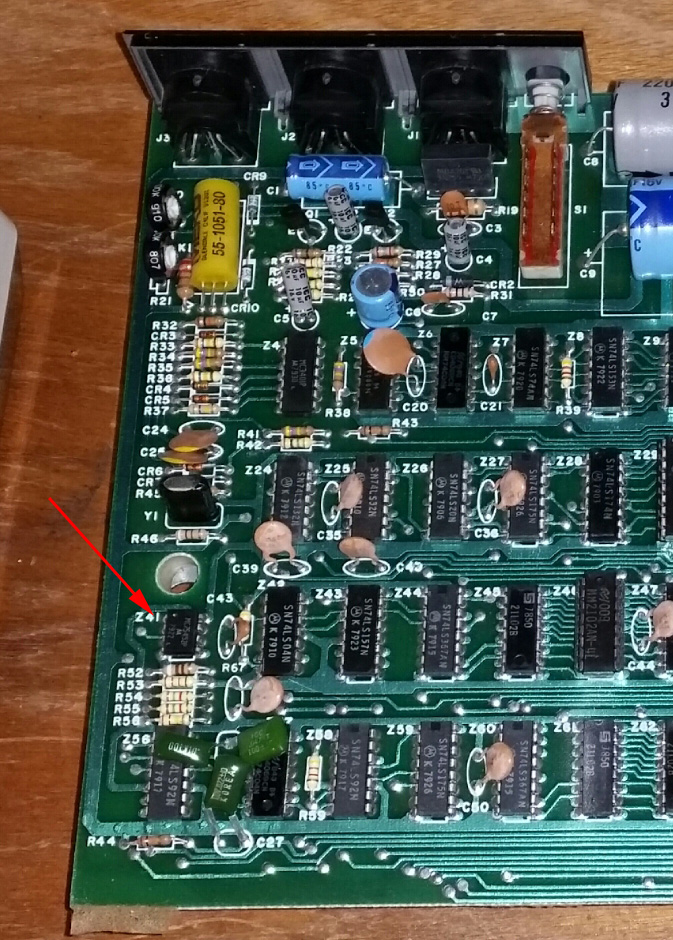

Postby tezza on Sat Mar 07, 2015 9:27 pm
Ok, I managed to grab some time today and repair this thing.
Actually it wasn't Z41. That did have a signal after all, although it was hard to see with the scope.
No, Audronic was onto it. On some more reading I got very suspicious of Z5 (a 74C00) as it feeds the base of a transistor (Q2) in the video circuit. This transistor wasn't switching on because the voltage coming from this chip to the base was too high. When I checked the voltages on Z5, input was ok but output on one of the gates was screwy. Replacement with a spare 74C00 fixed that problem and lo and behold, video appeared!
So in summary there were two issues with this board, a power regulator IC and a 74C00 Quad 2-Input NAND Gate on video sync circuit. The arrows show the offending pieces of silicon.
