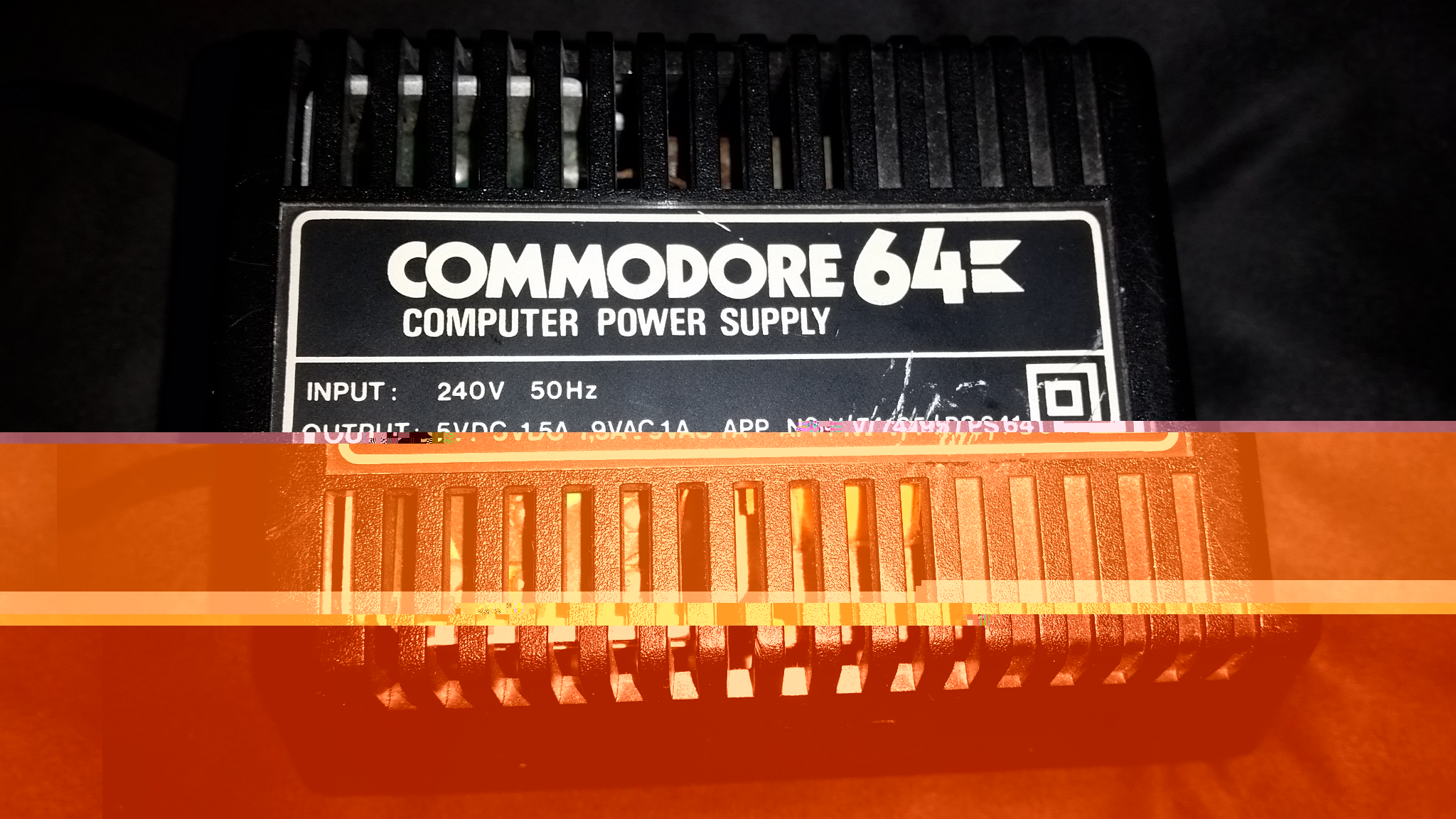

mons2b wrote:Ill put you as the first to try one NZ Zoomed. I went through some old C64s i have and one breadbin had a chip hot enough to fry an egg. I think a victim of a bad power supply. I plan to give one Breadbin the full delux spa treatment with new caps and heatsinks everywhere. I will also put a new cap in the one C64 power supply Ive found that can be repaired. The regulator 7812 in the power supply is attached to a huge heatsink so it should be ok but its more than 30 years old so a new one might be good especially as I can get to it.
Something I belatedly realized.. The 1541-II disc drives have a very similar power supply that is also usually sealed and could also be now putting too much voltage into your disc drive. Those who use those SD card replacements no worries for you. But if youre like me and you like using a real drive check that power supply too. On the large original drives the power supply is INSIDE the drive. I am going to try to look inside the one i have at some point and see what voltage its feeding out.
All power supplies should be checked really at this point. So your Vic 20 , c16, plus 4 etc. Be careful with mains voltages.

I totally agree. It would actually be possible to gut a original supply and squeeze a modern switchmode setup in there I recon but the trouble is that power supplies are mired in so much regulation and rules. Theres always a way though. Could get a chinese company to make ones in the same square size casing to the mm then you can remove the chinese case and put the insides in your own horrible carbonite box. What you do at home is upto you. That would be one way to do it.
The power supply i found would be a much better one to get duplicated though. No epoxy and good open venting. Probably why its still only just out of spec. Ive realised im going to need so many more regulators for the disk drives etc. I have some other computers like ones that are very important to me for sentimental reasons I want to filter the psu output on.
Looks like the best C64 original PSU.

wow, ive never seen one of those, and it appears it has screws, so the whole thing can be taken apart and have new regulators and caps installed :)
