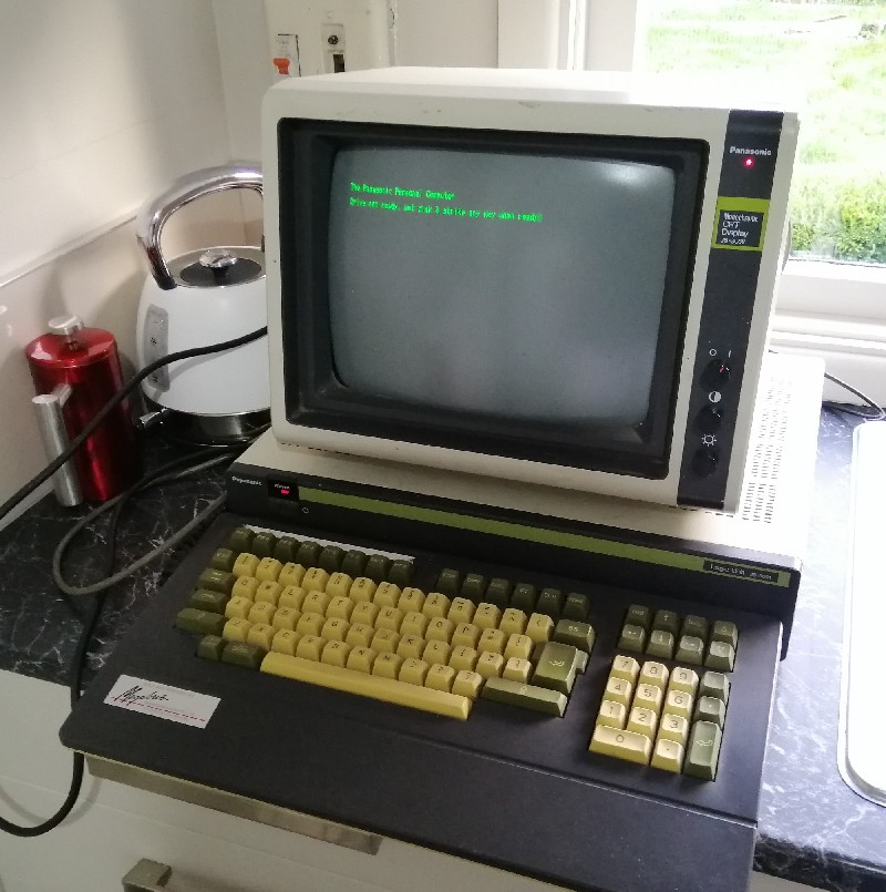

Postby Siggypony on Mon Jul 08, 2019 9:12 pm
Here is it running without the disk drives attached, their the largest part of the system and are still not unpacked
