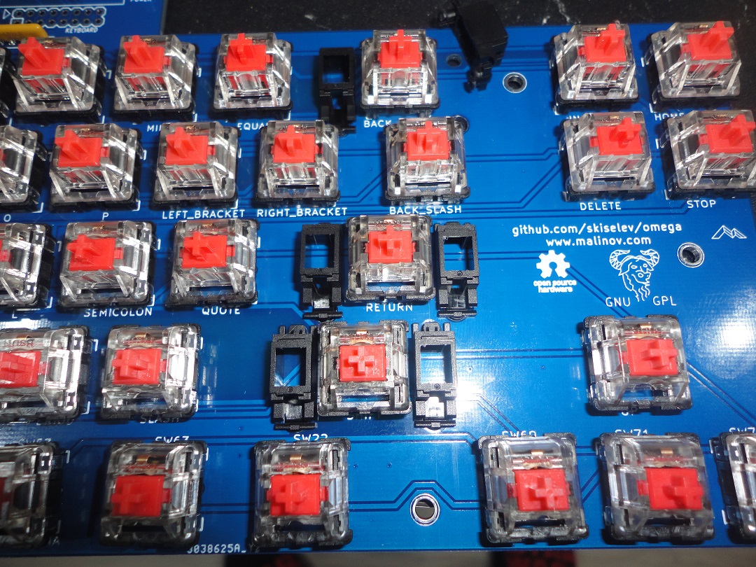

now for some info in attaching these to the board we need to go back a little.. and i found that if you put the mounts into the board by themselves, they will be easier to get in when you install the assembled and complete stabiliser units.
as i have showen below.
kb8
Postby LS120 on Fri Jun 05, 2020 6:33 pm

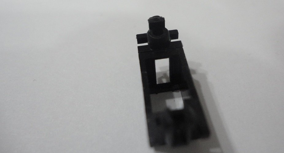

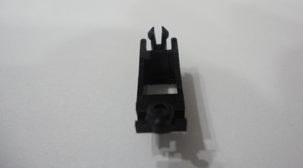

now to install the mounts they have 2 ends as in the first pic a push through clip and in the next a lip/ledge holder
now the clip goes to the top and the lip/ledge faces down.
you can put it in either way around but i found that putting the lip in first and then pushing the clip in after was easier to do.
clip end
Postby LS120 on Fri Jun 05, 2020 6:34 pm
lip/ ledge end
lip

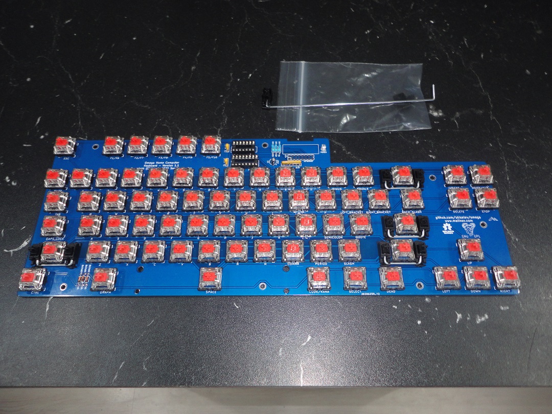

Postby LS120 on Fri Jun 05, 2020 6:40 pm
so after they have been in for a few minuets remove and assemble as i showed earlier and place them in there places. in the pic below i have not done the spacebar as i need to shorten the rod as they dont have the size needed and it needs to be shortened.
also note that the bars go on the bottom side of the switchs as in the pic.
it's all done but still waiting for the keyboard header. them ill put the ic's in.. and the key caps when they come..
:D
spacebar

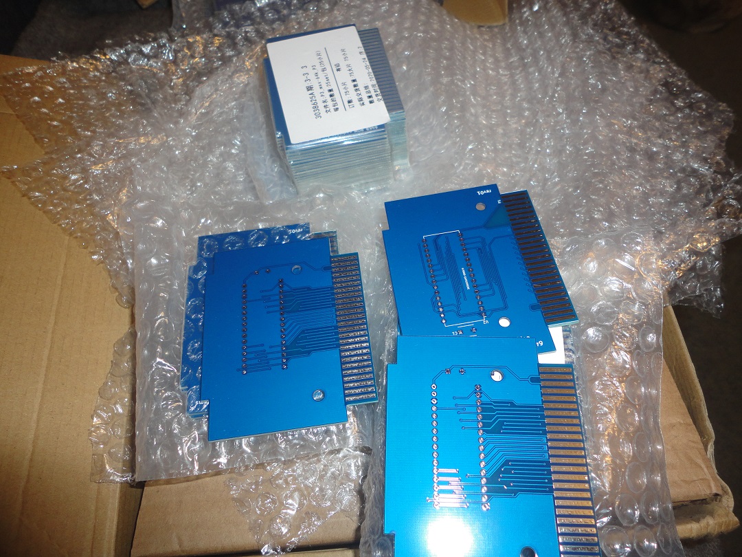

also if anyone is looking for some msx blank cart boards i have some .. these will take 64k roms (type; SST39SF010)
carts

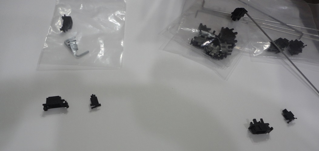

Postby LS120 on Sat Jun 06, 2020 9:38 pm
we just to show what i was saying about the mounts for the stabilisers . the short ones have the right type and the long kits don't.. as you can see in the picture.. you need a set from a short bar set to mount the long space bar.. as well as to shorten it a little.. as they dont make one the right size.
the left are the right ones (short bar) and the right hand one the mounts are wrong but the bar is what we need..
kb-bars

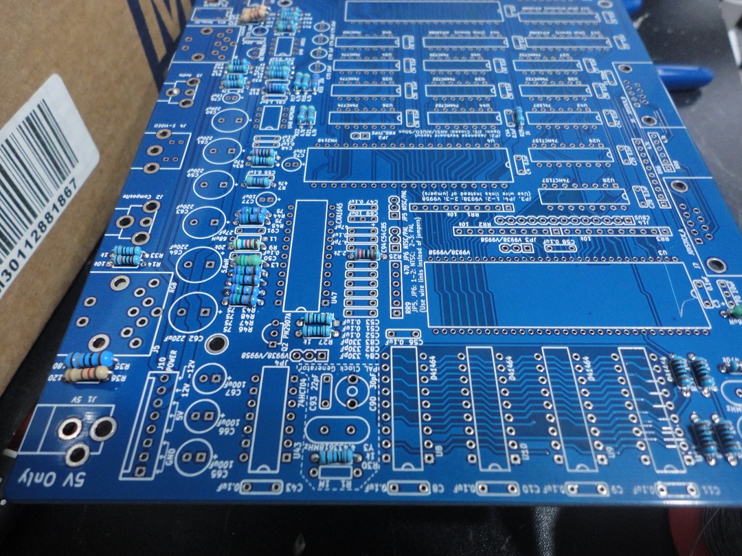

Postby LS120 on Sat Jun 06, 2020 9:42 pm

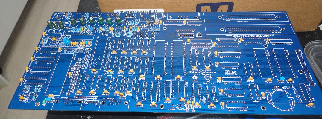

well have done some more today.. started with the resistors and found some i got were 1/4 watt and a little too big so made them fit and look ok..
disc1

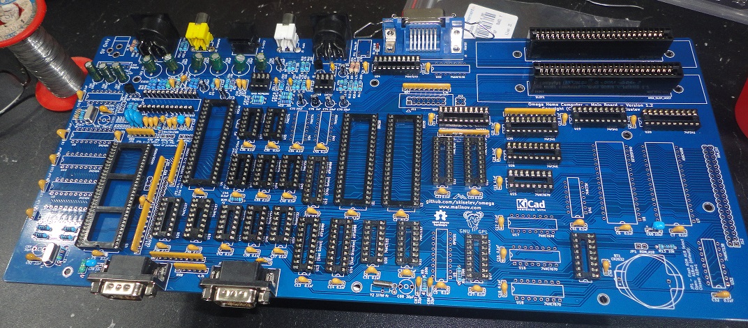

Postby LS120 on Sat Jun 06, 2020 9:46 pm
ok lunch over and done back into it again.. added some more components..
disc3

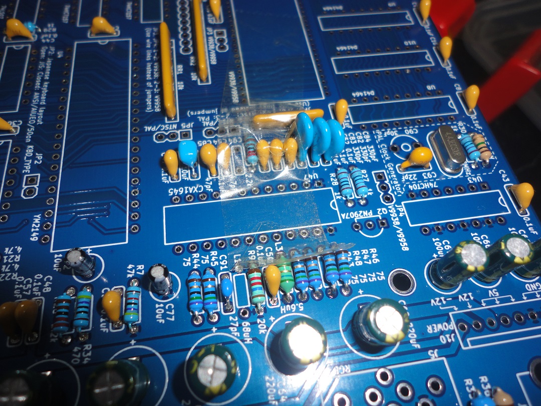

just a quick tip is i use some scotch tape to hold the resistor arrays in place while i solder them in then remove the tape. as in the pic added.
disk4

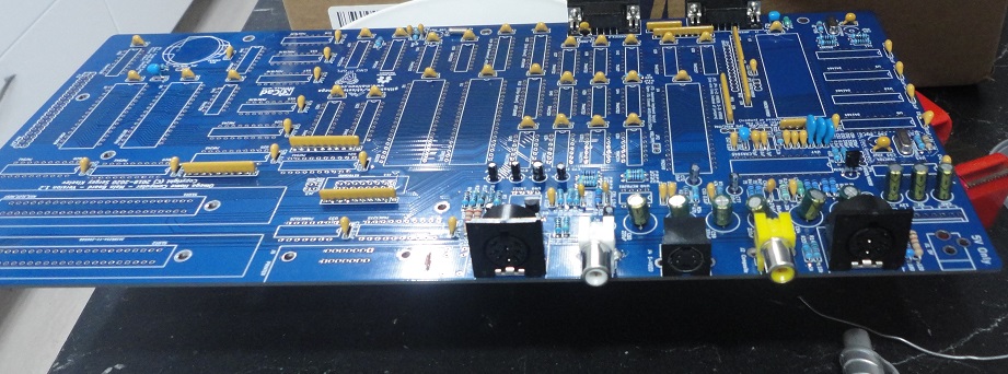

Postby LS120 on Sat Jun 06, 2020 9:50 pm
then added the crystals and some of the plugs
disc5

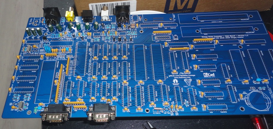

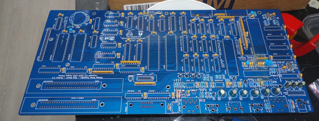

Postby LS120 on Sat Jun 06, 2020 9:52 pm
and from the other side...
well enough for tonight..
disc6
Postby LS120 on Fri Jun 19, 2020 5:04 pm
so had a few wet days and have done some more.. soldered what sockets i had (waiting for more from china) and a few plug as well.
unit seems to be coming together well.
sockets

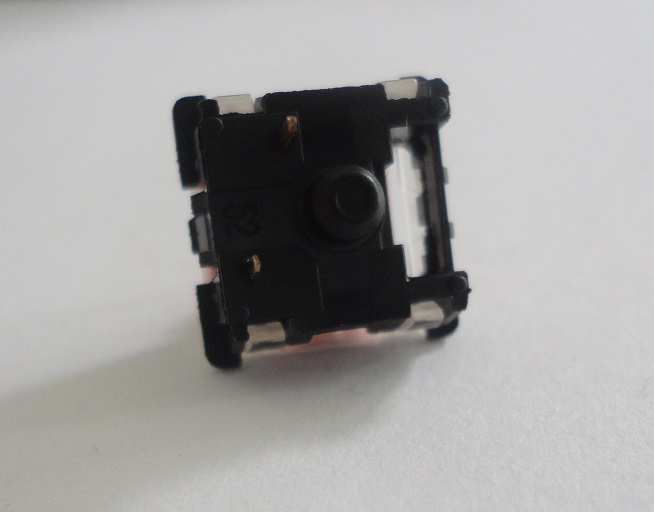

was looking at the keyboard part of this build and was trying to work out where/how the 2 extra leds attach.. it all comes down to the type of Cherry MX switches you get.. the ones i got have clear tops and then there is a type that has solid plastic tops.. as you can can see in the pic below the ones i got have an open rectangle window so i was able to solder the 3mm led to the board and in then sits inside the opening in the switch.
switch1

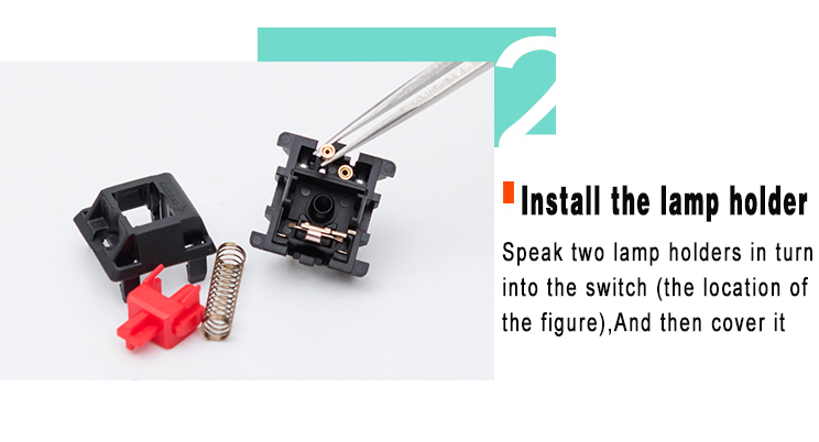

in the other type there are holes to put the led or some extra pins in to mount the led in the switch(these you have to buy separate to the switch).. to do this you need to open the switch and add the led and pin's. see the pics below to get an idea.
switch2
