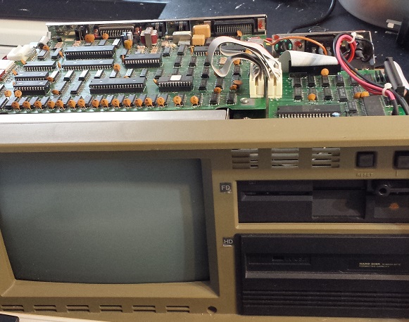

ok so i put the Bondwell-16 back together and booted it up..
Postby LS120 on Tue Apr 02, 2019 9:59 am

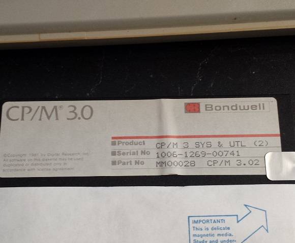

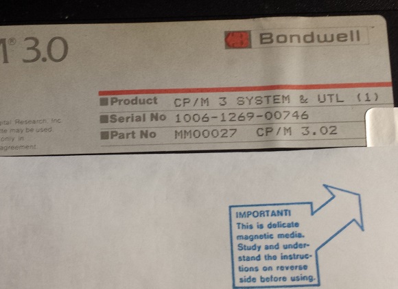

i tested the hdd boot but still has cpm3.sys missing so i try booting off disk1 of cpm-3.02 i got and it booted..
Postby LS120 on Tue Apr 02, 2019 10:01 am
a better pic sorry hand moved.. one thing i noticed was the hdd version was 1982 and the fdd was 1984 of cpm 3.0
Postby LS120 on Tue Apr 02, 2019 10:03 am
and the original cpm 3.02 i got from the USA.. now i need to know how to re system the hdd or to check whats on it.. any ideas?

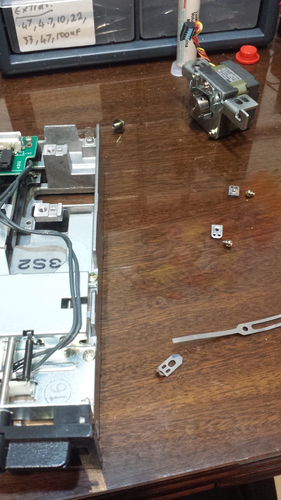

Postby LS120 on Sat Apr 06, 2019 10:42 am
so i stripped the stepper strap off the 360k that the motor was binding on and put it on the other drive.. what a pain in the A that was... well good news is that the drive starts and moves head to the outside of a disk that's inserted but that's it and comes up with drive error.. it may need the stepper motor adjusting as where the 2 screws hold it down they are slotted.. so have shelved the drive for later.. picked up a 360k i had on shelf and plugged in.. it spins up and tries to read the disk but has drive error.. i need to find jumper settings for it.. or have a play with them..

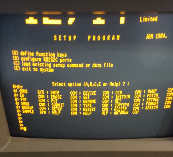

well having a break and coming back to play with the drives i got an Epson 521l to boot cpm as drive A and no other drive connected.. it did complain that drive B has a fault, but that's because i didn't connect it up... lol
so i decided to set the Epson to drive B and put the TEC back in and try again.. same problem .. it would just make a grinding noise the error out.. hmmm it should at least try and move the heads... so turned it off...
after scratching head for a little bit i decided that if the motor was spinning but the heads not seeking it must be the top board.. so i took off the one from the Donner with the spindle problem and replaced the one i was testing.. powered on and it spun up.. tried reading the disk but error out with disk error..
now that's better.. at least its trying to read the disk.. i know the disk is fine as the Epson reads it ok.. so lets try adjusting the stepper strap as its probably not reading the right area.. so out with screwdriver and undo and move 1mm and tighten... press reset.. nope still error.. move another 1mm test.. did this 6-7 times then whamo... chug chug chug.. it booted up .... cool...
dir listed drive files... cool lets see loaded speech and had a play... cool it works... now lets check keyboard keys... ok all but M and F4 work fine... poped off key tops to check.. hmmm work some times.. ok squeeze a little contact cleaner down shafts.. and press keys alot.. then up came the M and F4 (rename) programmed key.. leave for a bit and re-tested .. first time every time now.. so keyboard is working fine... all keys..

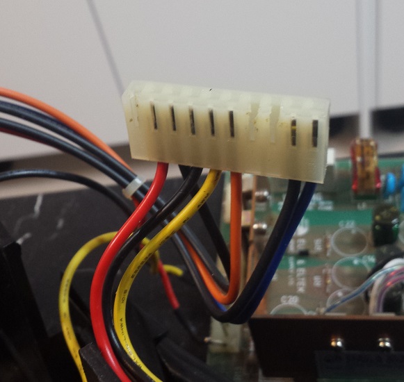

so i decided to remove all electro caps out of the mo/bo, psu and vdu boards to make sure there are going to be no problems.. what a pain in the Backside whom ever put these together didn't make it easy at all.....
they soldered some power wires to the pins and left others on the same plug.. from factory... why do this SH%^T i don't know..
but look at the pics to see what i mean... anyway i'm off to AU next wee so wont have time to do much and not back until beginning of may..

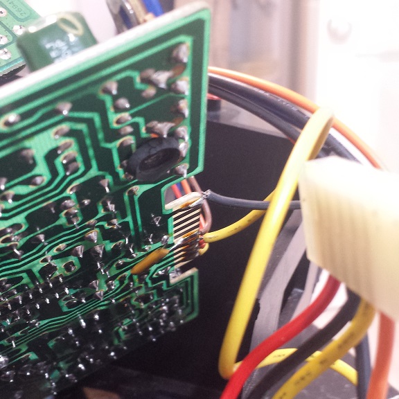

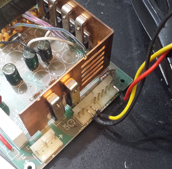

Postby LS120 on Sun Apr 14, 2019 8:54 pm
and more the altered plug..

Postby LS120 on Sun Apr 14, 2019 8:55 pm
and the VDU board.. soldered to psu

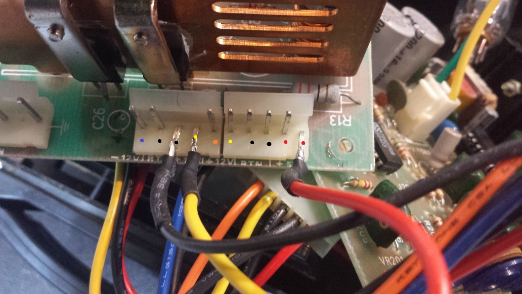

Postby LS120 on Sun Apr 14, 2019 8:59 pm
close up of the voltage pins.. -12v (blue),+12v (yellow), ground/ret(black) and +5v (red) the orange is +12v for the mo/bo
