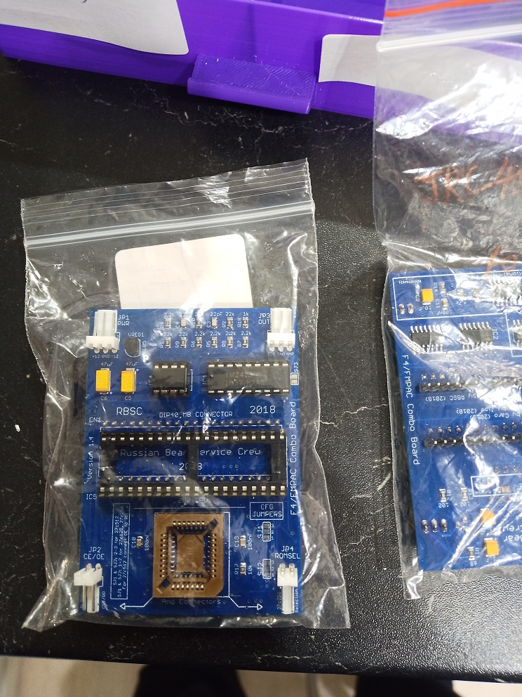

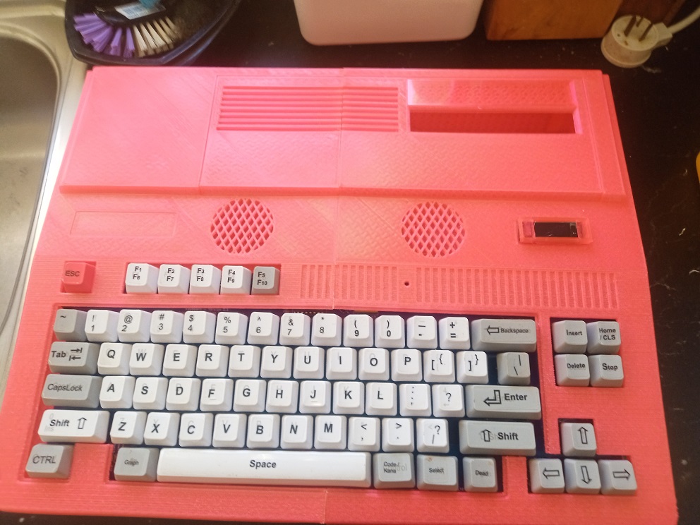

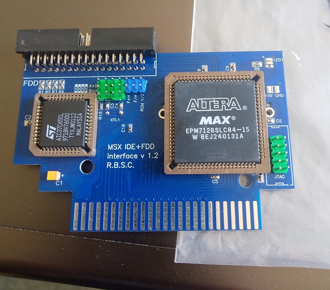

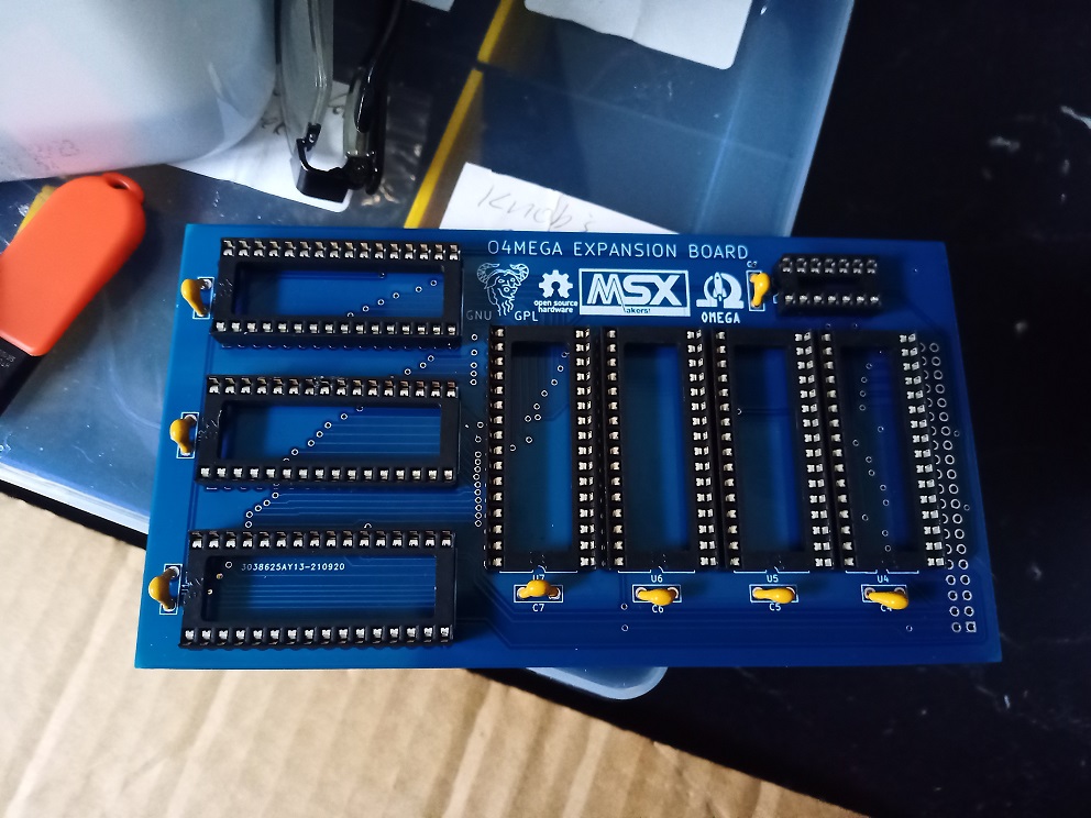

well for those that are following this post.. i have made some add on cards for the Omega msx.. i have the 4mb ram add on cards, F4/mpac units (complete) and some cf/fdd cards as well (waiting for ailera chips) also made a 728/738 style case for it as i needed more room for the addons.
Postby LS120 on Sat Jun 18, 2022 3:27 pm

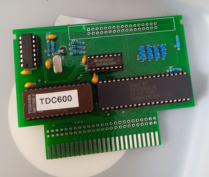

also made the td600 fdd card before i went to the cf/fdd cards..

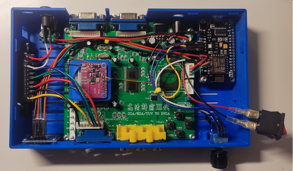

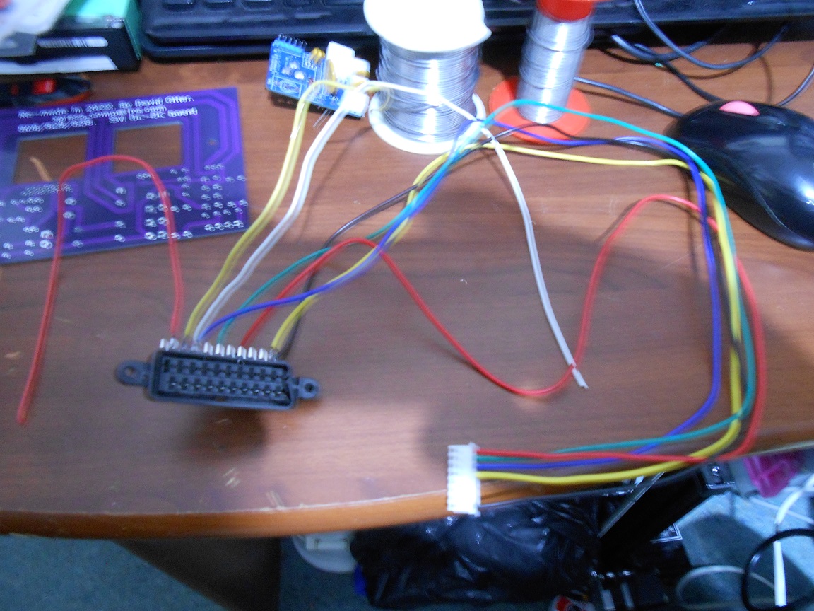

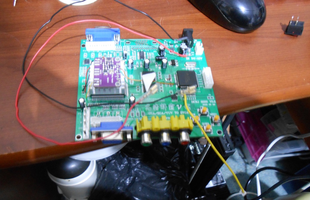

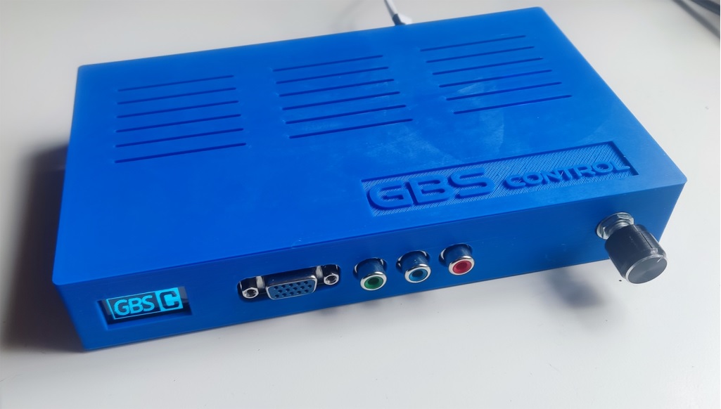

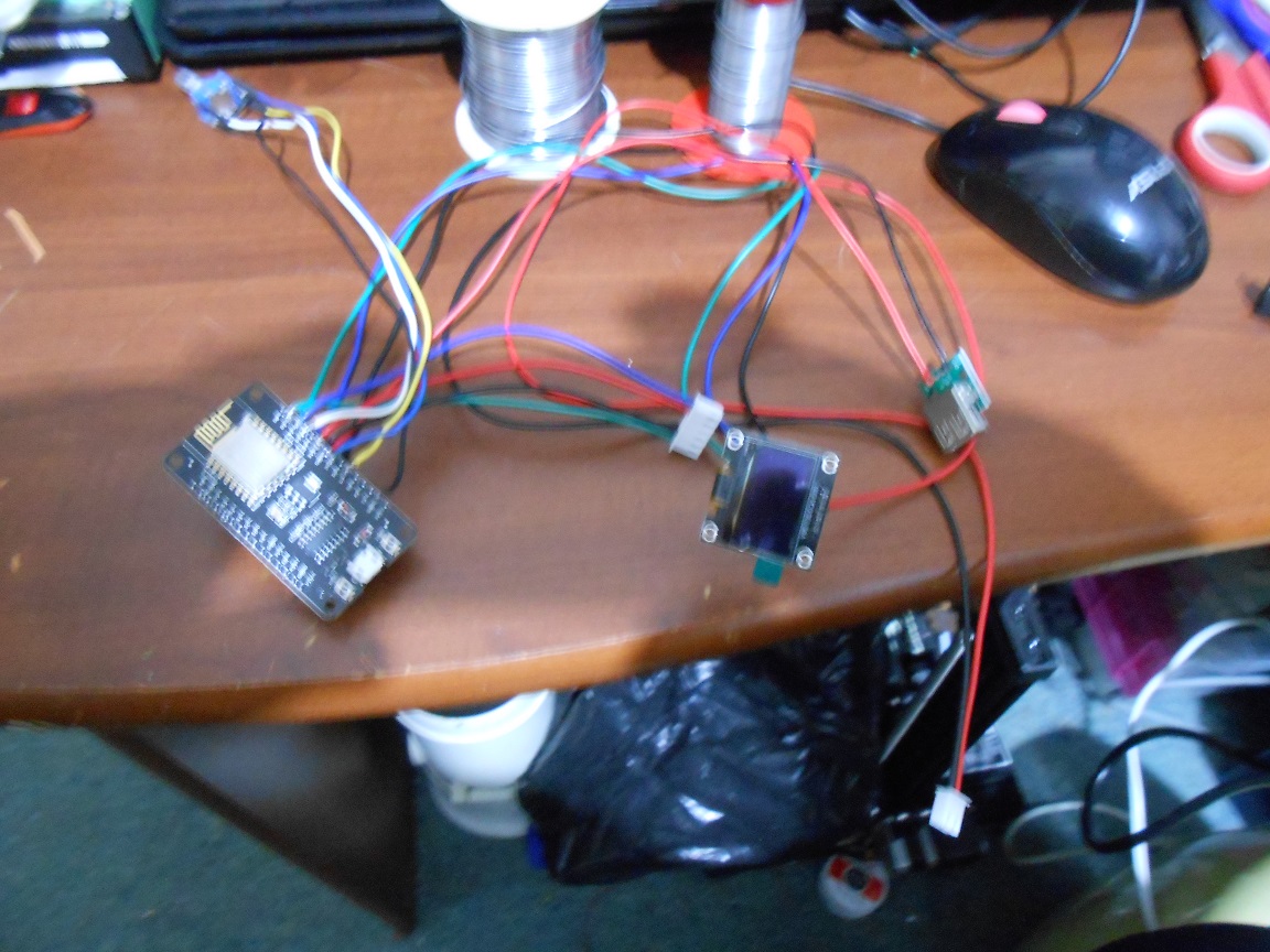

Well over the last few nights i have been Making the UPSCALER GBS with Robert Neumann's GBS CONTROL. have found it not to be a beginner project...and using the WiFi capabilities of the ESP8266. now i just need to print the case and test it.. I have used the GBS-8200 at this time although you can use the GBS-8220 & VC9900 as well.. To access all the functions of the «GBS Control» menu, we must access through a PC or a smartphone. or the OLED screen & rotary encoder.
Postby LS120 on Wed Aug 31, 2022 3:37 pm
build so far, just case to print
