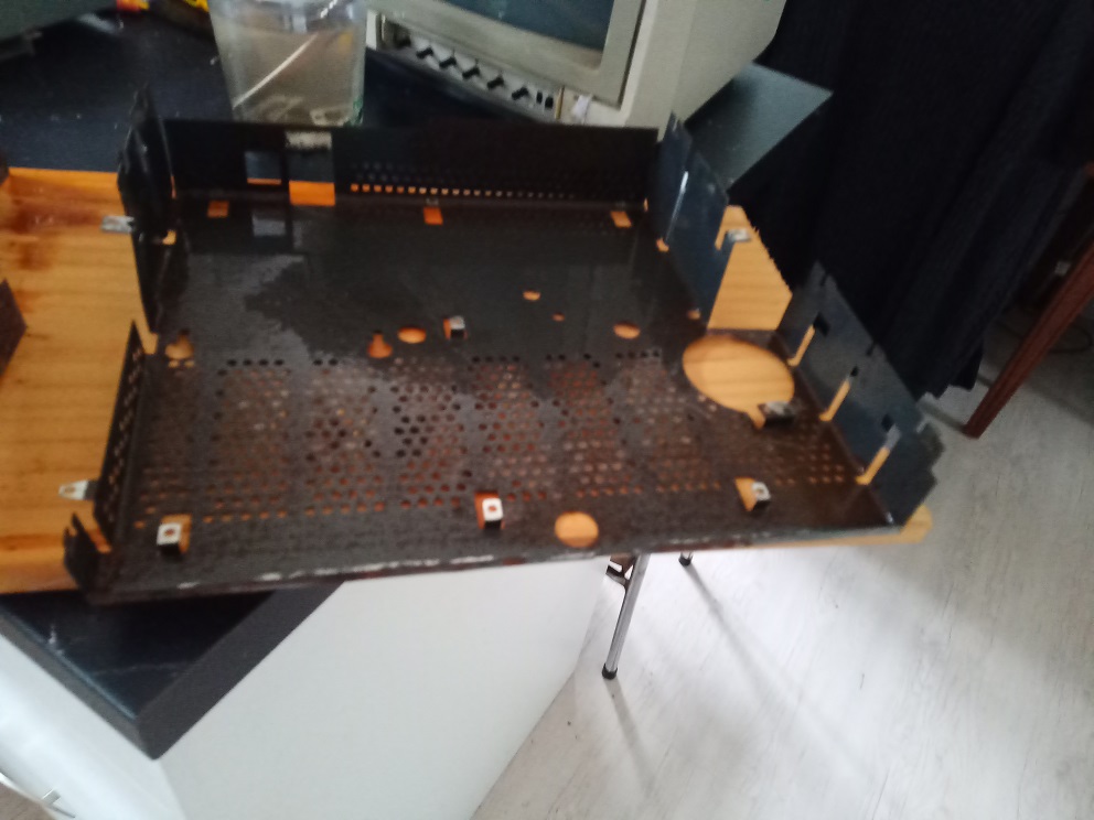

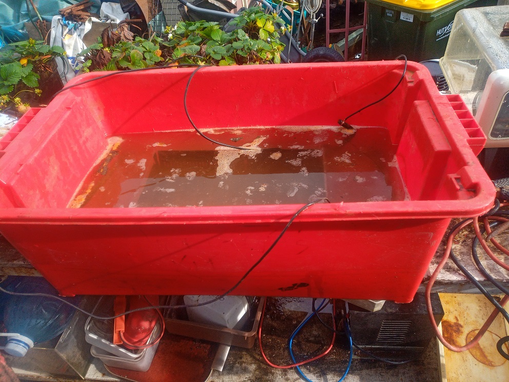

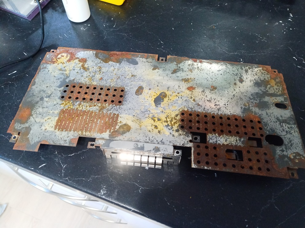

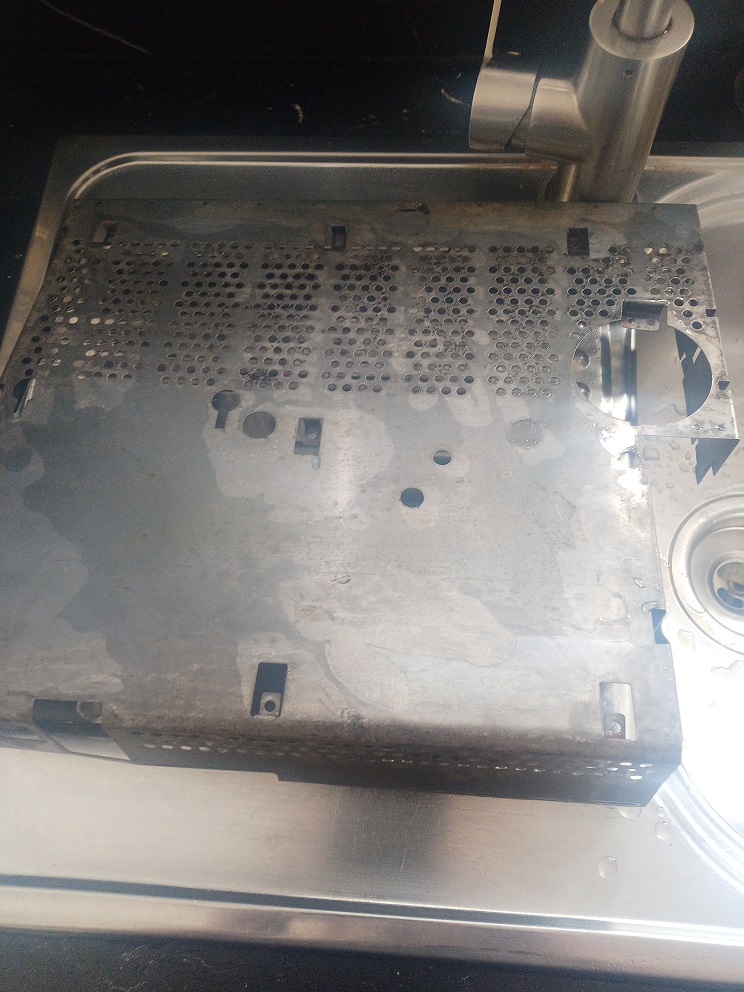

by LS120 » Sun Jun 05, 2022 1:45 pm

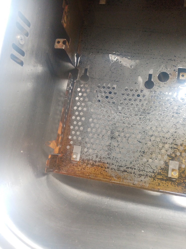

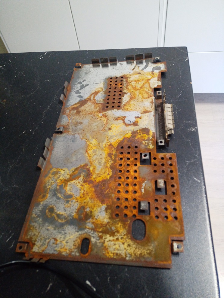

next thing i need to sort is the metal shields in the cases as they have seen some dampness... so i tried rust remover chemicals... and although they did work after some time they take a lot of time to do this way.. and after some searching and internet trolling i have decided on electrolysis.. and after my sad 2 day chemical trial i must say 12 hours in electrolysis is amazing... and it's safe as well no bad chemicals etc and cheap as well...

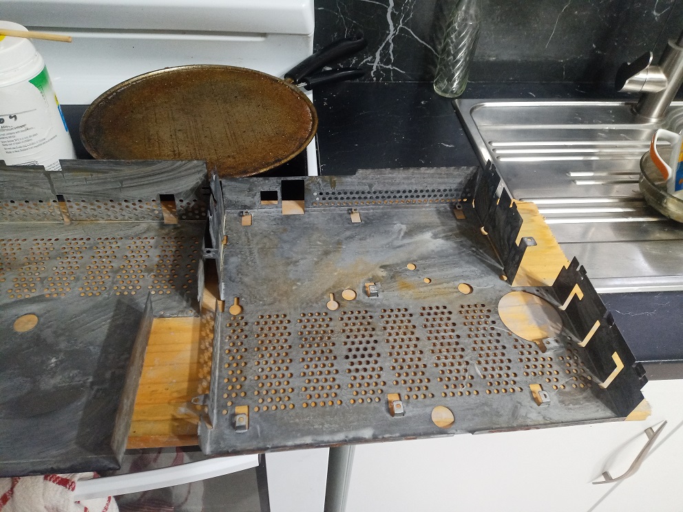

by LS120 » Sun Jun 05, 2022 1:49 pm
these are the pictures from after electrolysis.. the yellow is what is called rust bloom.. and is just a scum that washes off with warm water and i used a non-scratch pot pad and nylon brush.

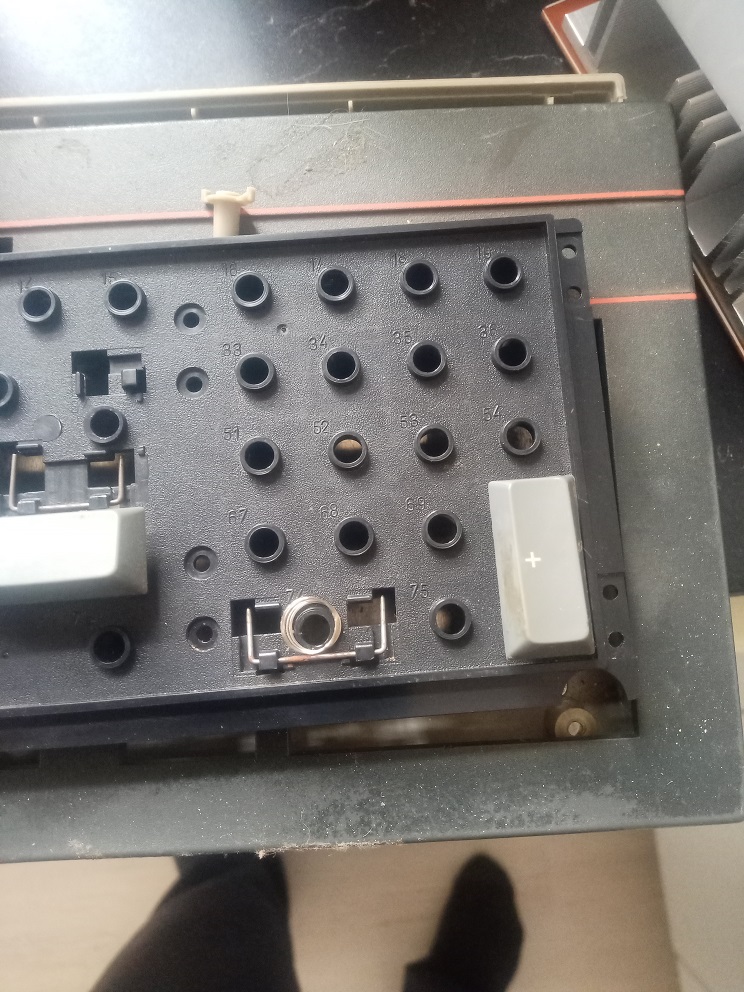

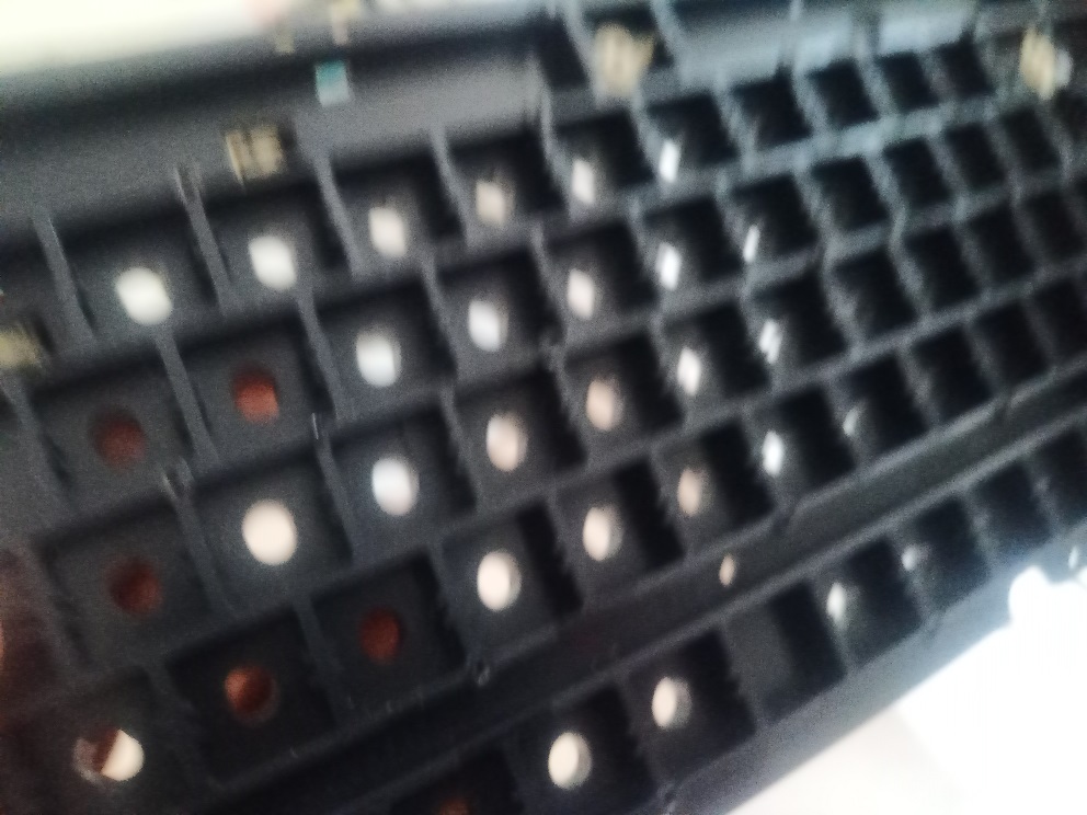

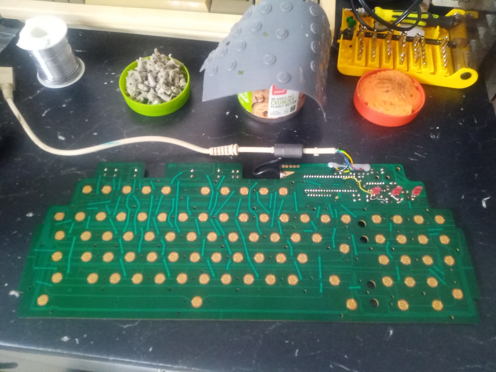

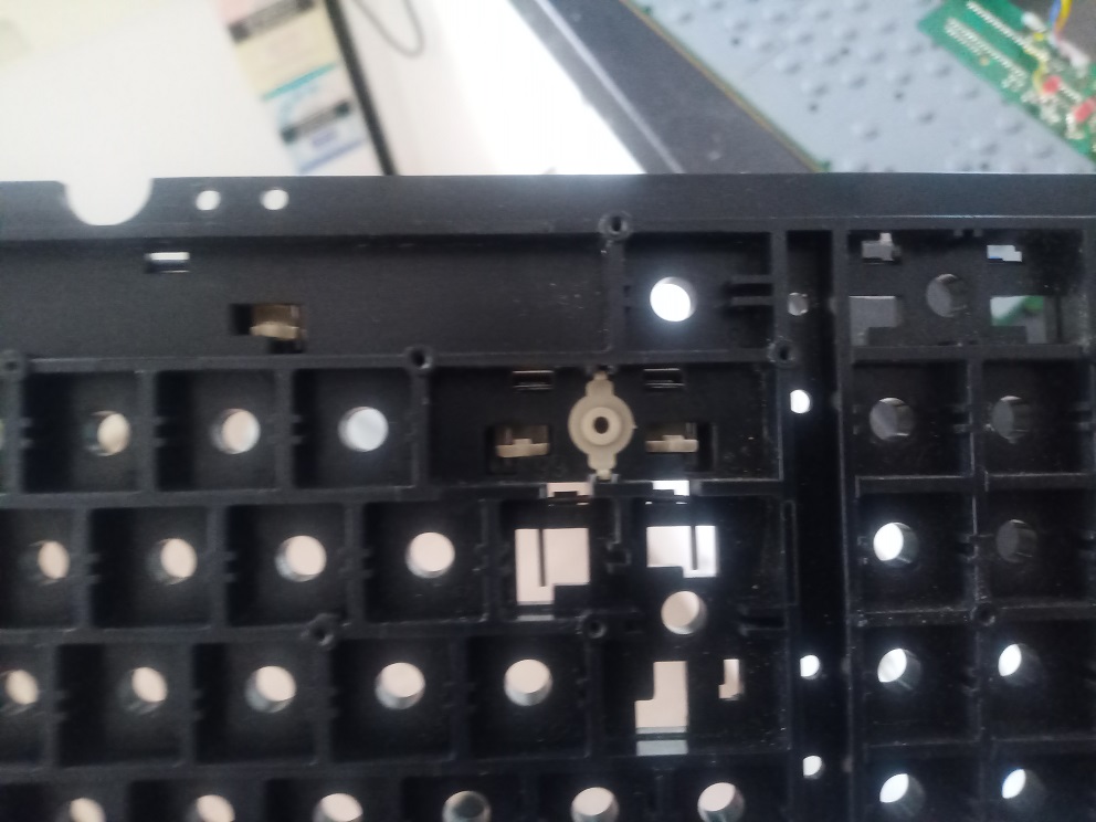

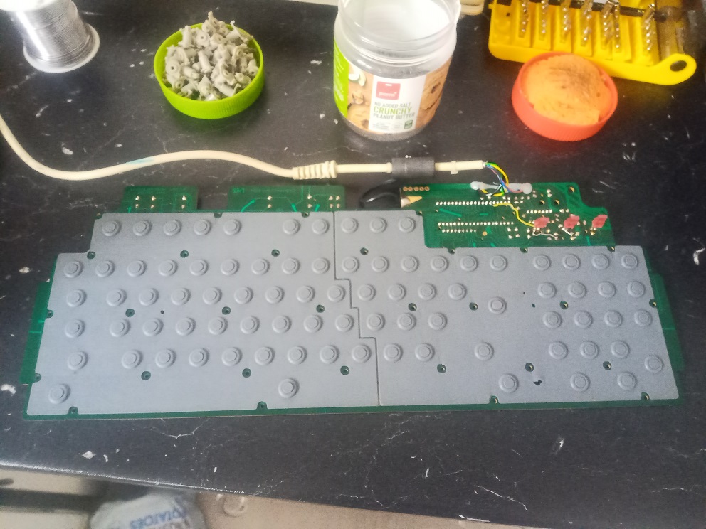

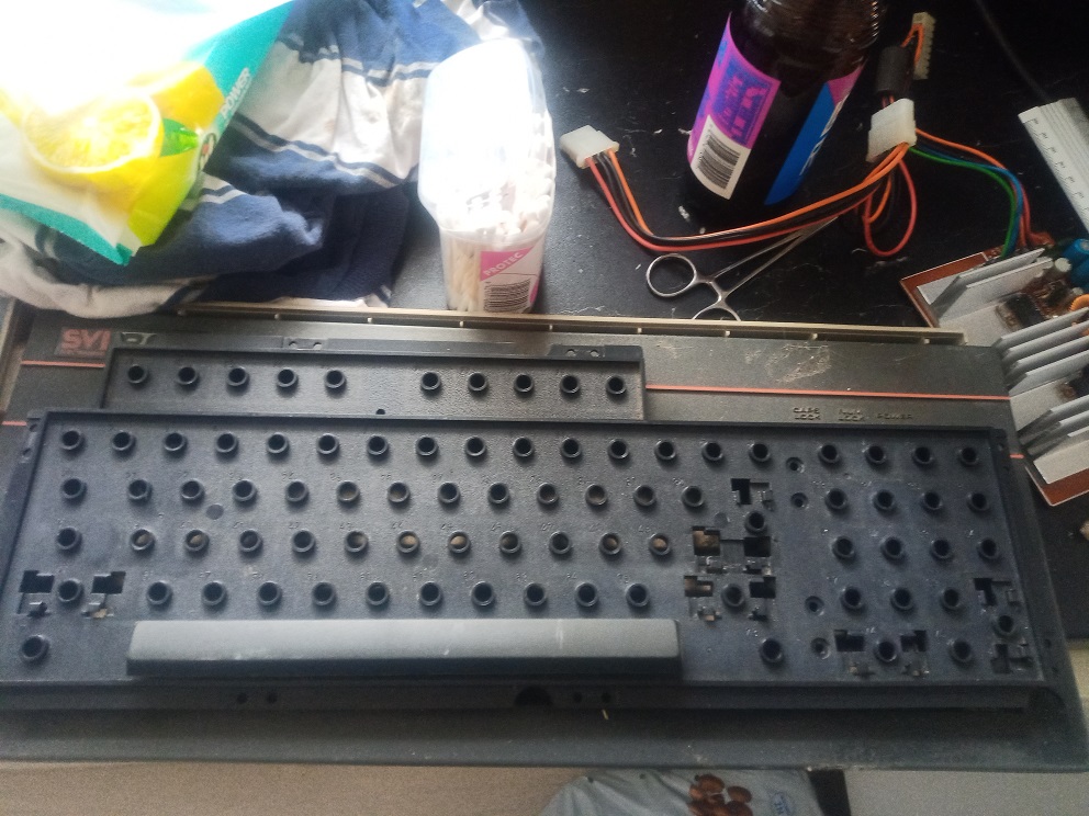

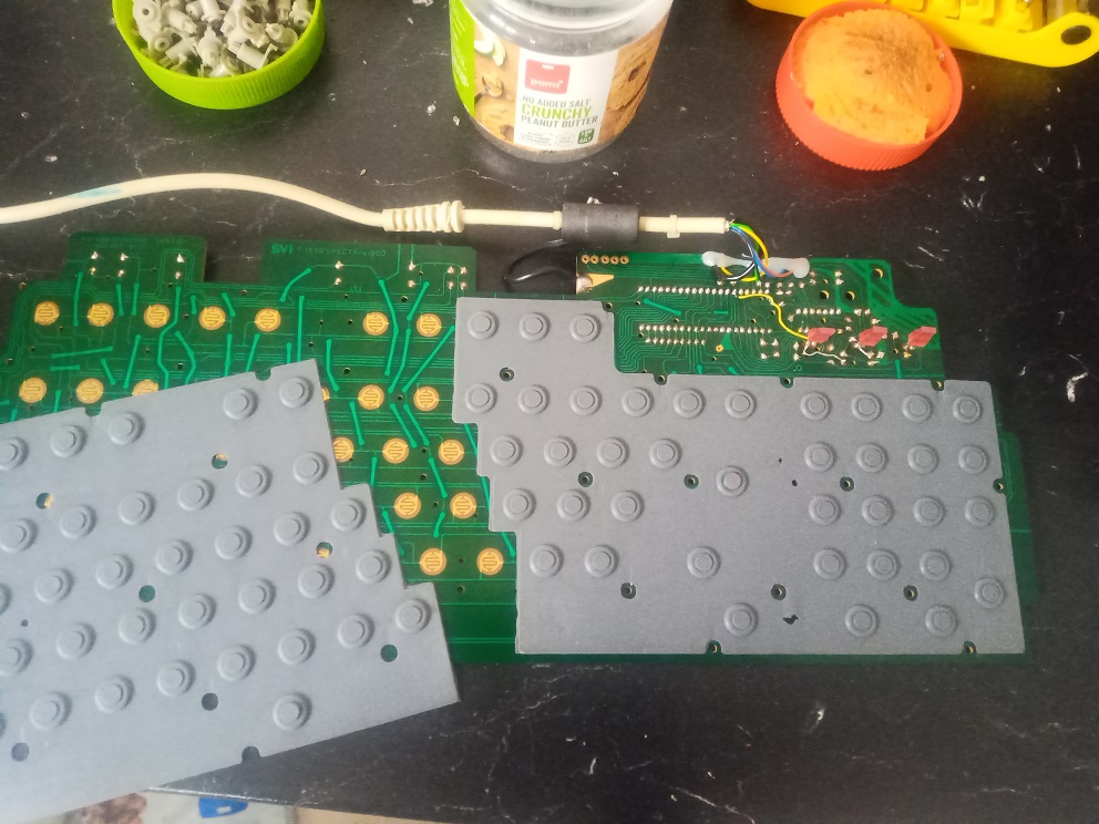

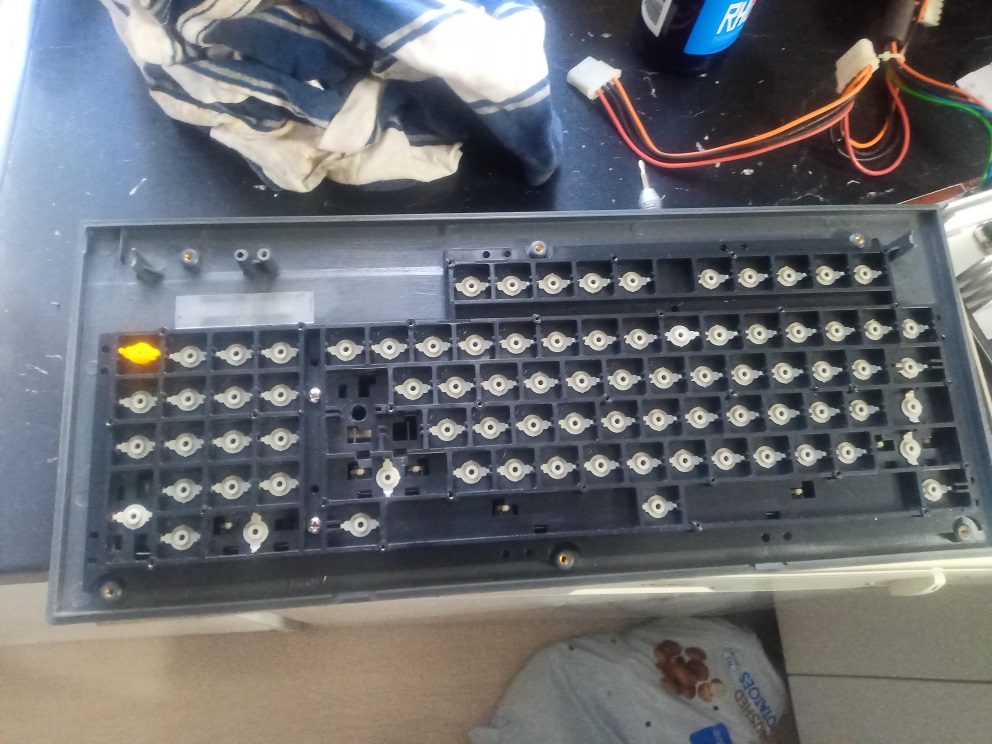

by LS120 » Sat Jun 18, 2022 2:05 pm

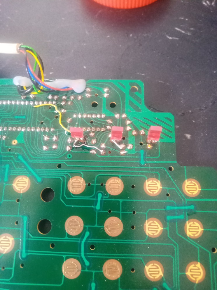

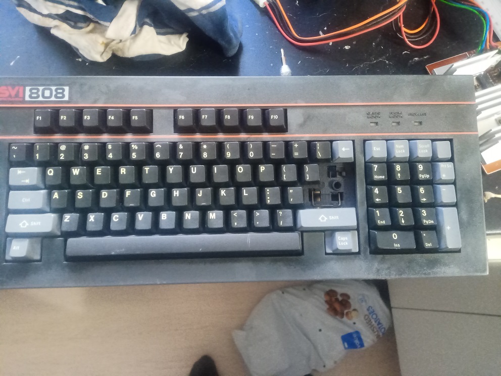

well with the weather the way it is and waiting for the nickel rods to arrive i went to cleaning up the 808 keyboard and keys.. i need to find an enter key for the keyboard but maybe an old AT L shaped key would fit... will need to have a look at my keyboard stash.. i stripped the keyboard down some months back as i needed to see if i could get some key plungers or print some .. and thanks to Philip in Christchurch he re-worked the SVI one on Thingiverse. that is the orange one you will see in the pictures.. the first thig i did was to fix the led's on the top of the keyboard as they have been repaired before but i have attached them more solid as they were just soldered on the top and that was it.. after that i cleaned the board and rubber key pads.. then started to re-assemble the unit..
by LS120 » Sat Jun 18, 2022 2:17 pm
re-assembling the key plungers and keys.. you have to make sure the little wire clips are the right way around.. but they come out to turn around if needed.. the hardest part was holding the spring and key in place while putting the plunger in the right way around as it has 2 sliders it needs to go into.
by LS120 » Sat Jun 18, 2022 2:18 pm
more assembly...
by LS120 » Sat Jun 18, 2022 2:20 pm
keyboard all done. just need to find that enter key..

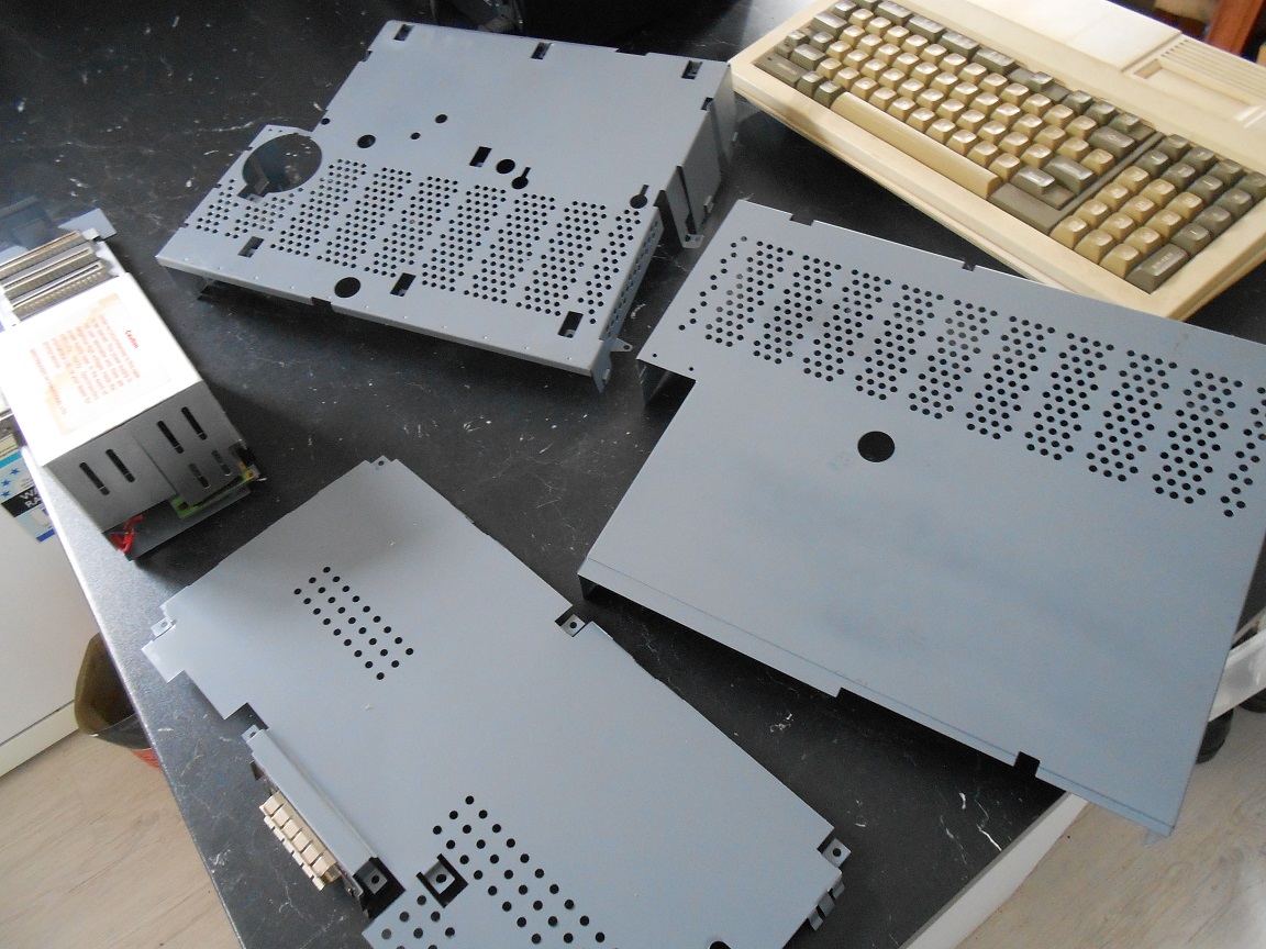

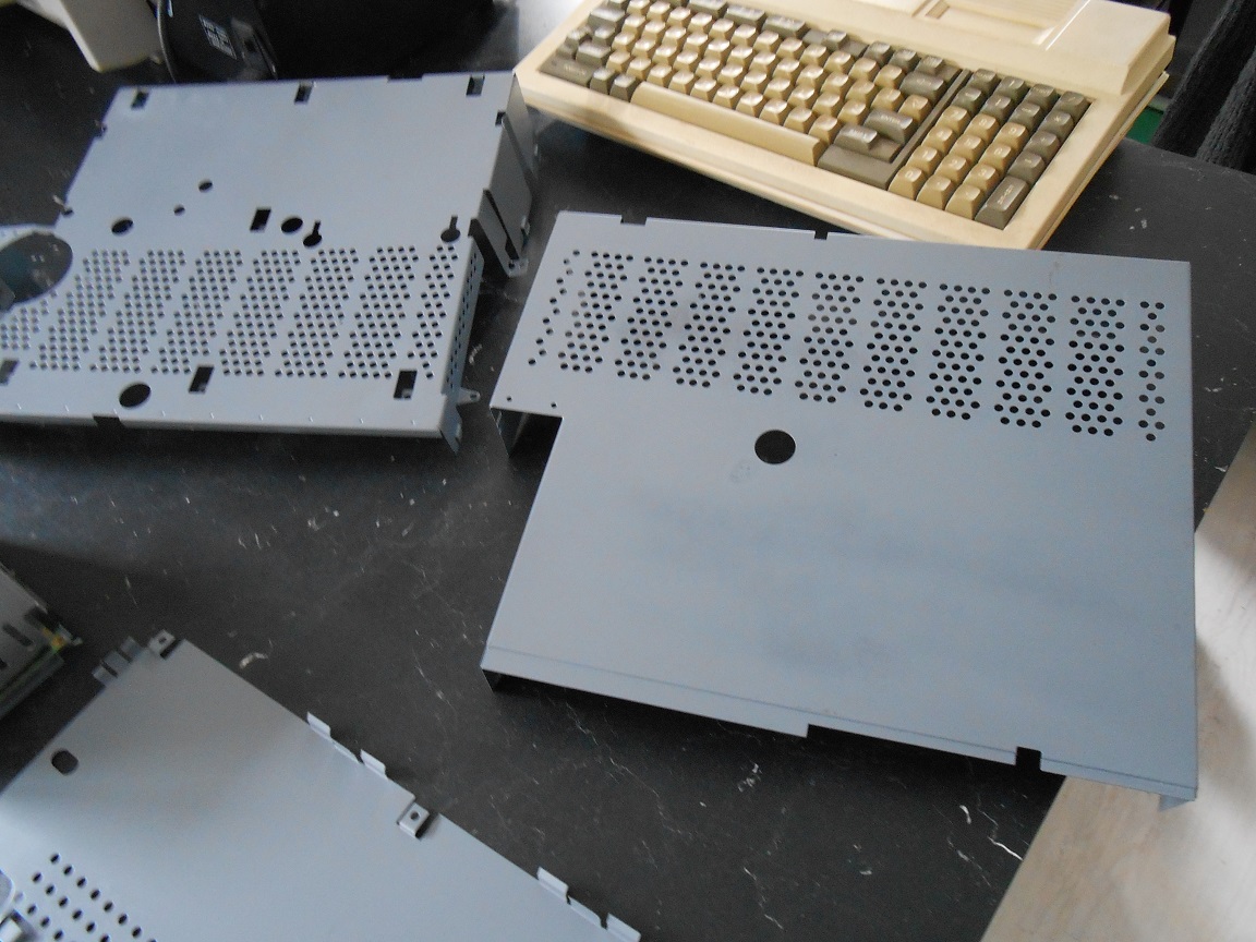

by LS120 » Mon Aug 15, 2022 6:52 pm
well as i was not happy with the final look of the metal shields i decided to primer them with grey rust primer paint.. and i must say they look a lot better.. now to find an old pc speaker for the slater eaten one and to re-assemble it..
