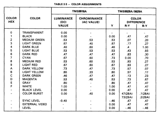

Essentially, the dodgy colour issue is not easily solvable, as the conversion from YUV to YPbPr is non-linear, as the colour weightings are different. To do it 100% correctly would require mathematical conversion from YUV to RGB, and then to YPbPr. This means roughly double the circuitry of a typical Sega Yeno RGB daughterboard. That's a lot of transistors, so a heavily IC-based solution would be ideal.
Interestingly, without any conversion, the YUV levels of the Sega are not OVERLY different from the YPbPr levels that your TV expects. Slightly weird shading of course, and that's what we've seen. What I find odd, is that the whites are not right, when in theory they should be the same. Perhaps attenuation at the trimpots is to blame? If the colour differences are at zero (relative to the zero level of the Y) then TV image should have no colour component at all.

Can someone give me a reality check on this? I've generated a bunch of swatches based on the various component schemes out there (using the TMS9929 raw values) to visualise the difference.
They all seem VERY similar.
Note, have forced values to be within 0% & 100% - i.e. trimmed all under/overflow. That colour #9 is def. wrong in the VDP datasheet.

natshaw wrote:Essentially, the dodgy colour issue is not easily solvable, as the conversion from YUV to YPbPr is non-linear, as the colour weightings are different. To do it 100% correctly would require mathematical conversion from YUV to RGB, and then to YPbPr.
I'm not sure if we are arguing the same point here, but mathematically I think the Y / B-Y' / R-Y' to Y'UV to Y'PbPr conversion is a simple scaling operation as U = (B-Y') * 0.492 and V = (B-Y') * 0.877. And Pb = (B-Y') * 0.564 and Pr = (R-Y') * 0.713
It all comes back to that identity equation of
Y' = 0.299R' + 0.587G' + 0.114B'
That defines a gamma corrected luma function based on the characteristics of the red, green, and blue phosphors that were common back in the early days of PAL and NTSC, and that appears to be what all of these SDTV colour spaces are based on. (HDTV has a slightly different colour space).
From that you can derive
B-Y' = -0.299R' - 0.587G' + 0.886B'
R-Y' = 0.701R' - 0.587G' - 0.114B'
Y'UV is just a scaled version of that where U is the B-Y' colour difference but scaled to a maximum of +/- 0.436. So U = B-Y' * 0.436 / 0.886 = B-Y' * 0.492
Similarly V is the R-Y' colour difference but scaled to a maximum of +/- 0.615. So V = R-Y' * 0.615 / 0.701 = R-Y' * 0.877
In other words, Y / B-Y' / R-Y', Y'UV, and Y'PbPr are equivalent and interchangeable provided you scale the Blue and Red colour difference channels by the appropriate scale factor for the output television system that you are trying to interface to.
So all you should need is a simple resistor / trimpot based voltage divider to transform between those three colour difference representations.
The only part of that I'm not sure is that the above calculations are all based on gamma corrected values. And I can't quite get my head around how relevant that is to the interchangeability of those colour spaces.
Y'IQ is a different matter because I and Q are not a direct scalar of B-Y' and R-Y'. The good news there is that I don't think Y'IQ is relevant for our purposes as it looks like it is more directly related to certain NTSC implementations.
But provided the target for consumer TVs is either Y'PbPr or Y'UV then I think those transformation issues are a side argument. The more interesting question is whether the target for consumer TVs is a different colour space that you cannot use a simple scaling transformation to shift to. If that is the case, then your assertion that you need complex circuitry to properly correct the colour balance is effectively correct.
But what we really want to know is why the TVs display a different colour set to what we are hoping for.
I don't actually think it is related to the exact colour space transformations. I think it could be as simple as that consumer televisions don't conform very closely to broadcast standards. I suspect that if you fed an appropriately scaled signal into a calibrated broadcast quality TV monitor that supports 288p video, then we could get something very close to the correct black, white, and colour levels we expect, and it once you get it right it should work the same on all broadcast quality TVs. But that isn't what I've observed with consumer TVs and monitors. They all treat the input slightly differently. And depending on the TV's brightness, contrast, colour saturation, and sharpness settings you will get further transformations applied to the incoming signal. And the situation gets complicated further still as soon as you move away from an analog CRT screen and the display then starts to digitize the incoming signal and map it to a digital colour space and interpolate it to fit on screen.
natshaw wrote:Interestingly, without any conversion, the YUV levels of the Sega are not OVERLY different from the YPbPr levels that your TV expects. Slightly weird shading of course, and that's what we've seen. What I find odd, is that the whites are not right, when in theory they should be the same. Perhaps attenuation at the trimpots is to blame? If the colour differences are at zero (relative to the zero level of the Y) then TV image should have no colour component at all.
Yes, dammit. I know exactly what you mean about the white levels. Ummm... this bit is kind of hard to explain in text form. We'll have to catch up again some time to swap notes when life settles back down a bit :)
The first thing we are assuming when complaining that we should get a pure white due to the zero colour difference is that your TV can correctly detect the 'zero' voltage level of the incoming B-Y and R-Y signals. By 'zero' voltage I mean the voltage level where B-Y = 0 and R-Y = 0. This is not 0v. And it is not (necessarily) the same as the blanking level or Vblack on the Y channel.
My last breadboard design tried to make that easier for the TV by using the built in sync tip clamp of the THS7314 on the Y channel input, then using a LM1881 video sync seperator, a NOT gate, a CD4066B analog switch, and a diode to generate a keyed clamp that would allow me to set the 'zero' point of the B-Y and R-Y channels to an arbitrary voltage. So I was outputting a 1v p-p Y channel signal, with a B-Y and R-Y signal scaled significantly below the 700mV p-p with the 'zero' level centered half way between the black level voltage and the white level peak. This is a single supply system, so all voltages are positive voltages.
Then from memory (this was several weeks ago), I tried looking at the system just in black and white by zeroing out the amplitude of the B-Y and R-Y signals, but still leaving the 'zero' level offset in there. And I could never quite get a perfect white doing that. I could only get a perfect white by completely disconnecting the B-Y and R-Y signals. So that says that the TV's definition of the 'zero' level was different from mine. And the TV was obviously doing something like a keyed clamp itself because I could shift the zero voltage level of the B-Y and R-Y signals up and down quite a bit without really affecting the picture.
But the flip side of that is the TV is also struggling with my black level as black is significantly brighter on my current component breadboard design than a side-by-side comparison with the original composite output.
It is also hard to pin down which part of the system is causing a given colour balance issue because your experience will likely vary a bit on a different TV, and it may also vary depending on your TV's brightness, contrast, and saturation settings.
So... the perfect solution still remains frustratingly elusive :) I suspect there is no perfect out of the box solution for consumer grade TVs, but I still think there is a good solution here that will work for a lot of people if we can just improve it a bit more.

natshaw wrote:Can someone give me a reality check on this? I've generated a bunch of swatches based on the various component schemes out there (using the TMS9929 raw values) to visualise the difference.
Nice job. I tried something similar before in reverse a page or two back where I took the Sega SC-3000 palette from MESS, assumed that was a 'correct' or at least close to correct RGB representation of the TMS9929A palette, then tried to map the voltages listed in the TMS9929A datasheet to those RGB values. That matched almost exactly (apart from colour #9) if you assume that the voltages in the TMS9929A datasheet are unscaled B-Y' / R-Y' values (ie. where B-Y' has a +/- range of 0.886 and R-Y' has a +/- range of 0.701).
However :) Just one thing to bear in mind with that is that once I read the C actual code for the TMS9929A colour emulation in the MESS source, it appears that whoever chose those colours did what I did in reverse. ie. they assumed that the TMS9929A datasheet contained unscaled B-Y' and R-Y' values, and calculated their choice of RGB values based on that and put them into the MESS emulator code base. They *could* for instance actually be in the Y'UV colour space ranges, which I guess is what you were trying out with the colour swatch.
The key point there is that the person who selected those colours for MESS isn't necessarily correct :) So all I have done there is to validate a reasonable assumption that someone else made about what the correct mapping is. That assumption may well be correct, but no way to know for sure. So we don't have a 'gold standard' for the correct palette to compare against.
For instance, Wikipedia suggests a slightly different palette for the MSX. But then again, that table refers to the TMS9918 which may actually have a slightly different colour balance.
MSX Colour Palette
http://en.wikipedia.org/wiki/List_of_8- ... SX_systems
This bit is useful reading for how to read the YPbPr values in the tables in that article.
http://en.wikipedia.org/wiki/List_of_8- ... deo_colors
And I also like this bit as it refers to the difference in the actual perceived colours when viewed through an RF modulator.
Also, when seen on TV devices through an RF modulator, the perception of these colors may be not corresponding with the original YPbPr ones (most noticeable with NTSC TV color system, due to its YIQ color space plane is not one-to-one compatible with YPbPr and YUV).
So... the other side of this argument is that the exact colour mapping isn't necessarily that relevant. The original Texas Instrument engineers chose some fairly arbitrary values to display on the primitive CRTs of the time, and which would give you colors that can be saturated out quite a lot by the colour adjustment controls on those displays. ie. you kind of expect the end user to boost up the saturation to some sort of personal preference level so that the displayed colours don't look exactly like the 'true' RGB representation anyway.
But you notice some colour imperfections more than others. Getting a good black and a good white are important. The tricky issue in practice is maintaining those whilst still being able to saturate the other colours and keep them all in the right range.

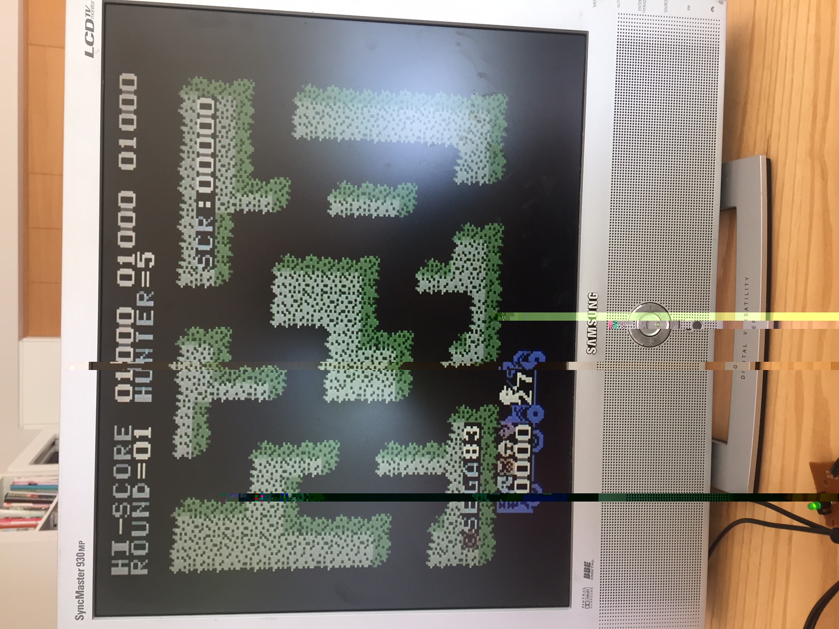

Test Pattern. It looks better than this live. My iPhone always struggles to get a decent picture of a CRT. In particular the black is very black. The white is ever so slightly greyish still. Blues and reds very blue and red. Greens and yellows a little muted, but nice. As discussed previously games are almost unwatchable if all of your colours are super bright as it is too hard on your eyes, so this is actually a pretty nice balance.

Those correspond almost exactly to the voltage offsets from the TMS9929A manual, as discussed back in 2013.
So for instance from that table you can see that Vnocolor is Vblack + 0.47v = 2.36v + 0.47v = 2.83v (closely matches observed 2.80v to 2.84v), and for the dark blue colour B-Y = Vblack + 1.00v = 3.36v (closely matches observed 3.32v), and for the cyan colour R-Y = Vblack + 0.00v = 2.36v (closely matches observed 2.38v).
3. So based on the above, we know that Y / R-Y / B-Y must be scaled by 1 / 1.44 = 0.694 at the TV outputs to get them into the 1v p-p range for Y / Pb / Pr. Call it a factor of 0.7.
