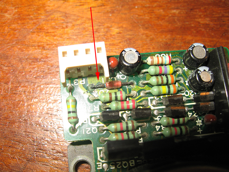

I've just had a drive fail on my Epson QX-10. The problem is with the motor and on the motor circuit board there is a diode that has rusty legs and a light covering of green fuzz where the legs meet the diode. I haven't checked it out yet, but it's a possible candidate for part failure.
Point is, it is nowhere near a battery.

I have seen it exactly how tez has photographed it - for me it's always been a ziener diode like in the photograph- in a few places over the last few years, and on one occasion the diode lost it's leg as a result. This included at least one 8088 motherboard which had no battery present. Most of the time however, it seems to grow starting from a Nicad barrel battery.
