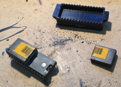

There is of course another option when trying to replace DALLAS type chips - grind out some resin and add a battery to the exposed metal. I'd always thought this to be both a barbaric and risky way of doing it - what if I cut into the Lithium battery and end up with an small explosion? Or even worse, grind off too much resin and have no metal left to solder on to?
Heaps of descriptions on the web on how to do this, but most end up with AA cells taped into place, or some nasty soldering attempts directly onto button cells. Again, benchtop explosions are no fun - especially when mercury or worse is sprayed around.
But I bit the bullet and had a go.

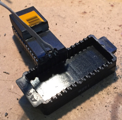

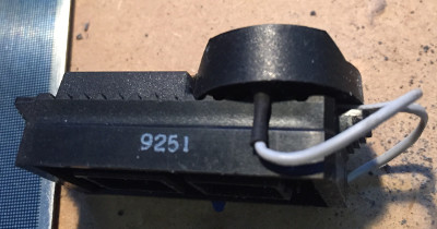

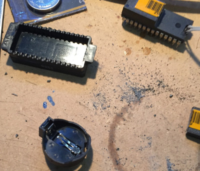

48T08 IC's are a double deck affair. ROM sized package underneath with a half crystal, half battery layer on top, with thin leads at each end connecting the two. The deal is to saw the top in half, chip away at the resin and ping off the lower end (ie not the bit with the Pin1 indicator).
Next, the delicate art of soldering a couple of leads onto the exposed contacts on the lower IC. This is propped up on the IC socket shield which provides a keyed shroud around the motherboard socket and allows easy removal (if you have small enough fingers to reach the "handles" at each end)

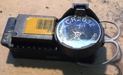

Next I had to find a better way than just velcroing a battery box into the somewhat crowded case (SparcLX is a "lunchbox" style 25cm square unit) - I noted in one guide that a chap epoxyed a CR2032 socket on top - that made sense, and something easy located in the garage on a Saturday morning. Enter a donor HP desktop that has seen better days. A bit of desoldering later, a nice shiny CR2032 socket ready to add to the mix.

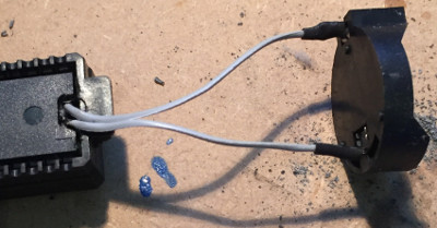

Soldering on the leads, and covering all sins with heatshrink:
And popping the unit together - looks like some pseudo cockroach!

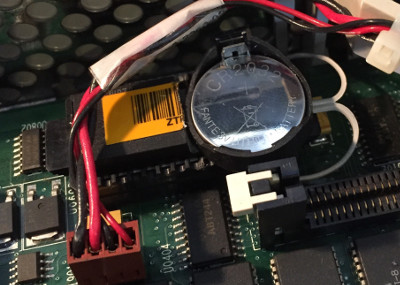

...and a wee close up of the side - dynamic tension seems to be more than enough to hold things together.
Next it goes back into the socket.
I mentioned before that the case is quite tight - what you can't see here is the top half which has the PSU and drive caddies which sit quite snugly on top of everything else.

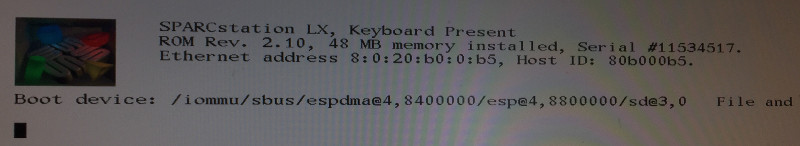

And lastly, the new boot screen (well, and abridged one without the RAM check) showing the new Ethernet address - The 08:00:20 bit is mandatory for a Sun I think.
Yes, I am that immature - but I had to think of something that could be said in hex...
