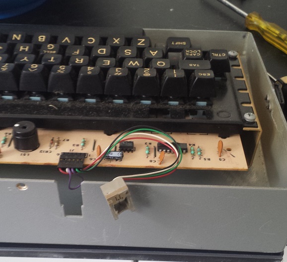

open'd up the first and found the keyboard plug on the keyboard unit broken so will have to replace that..

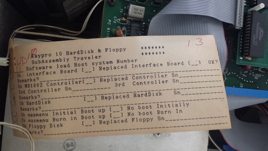

another nice thing i found it had not been opened and had the HDD tag still in it..

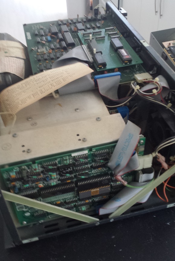

Postby LS120 on Mon Apr 15, 2019 5:14 pm

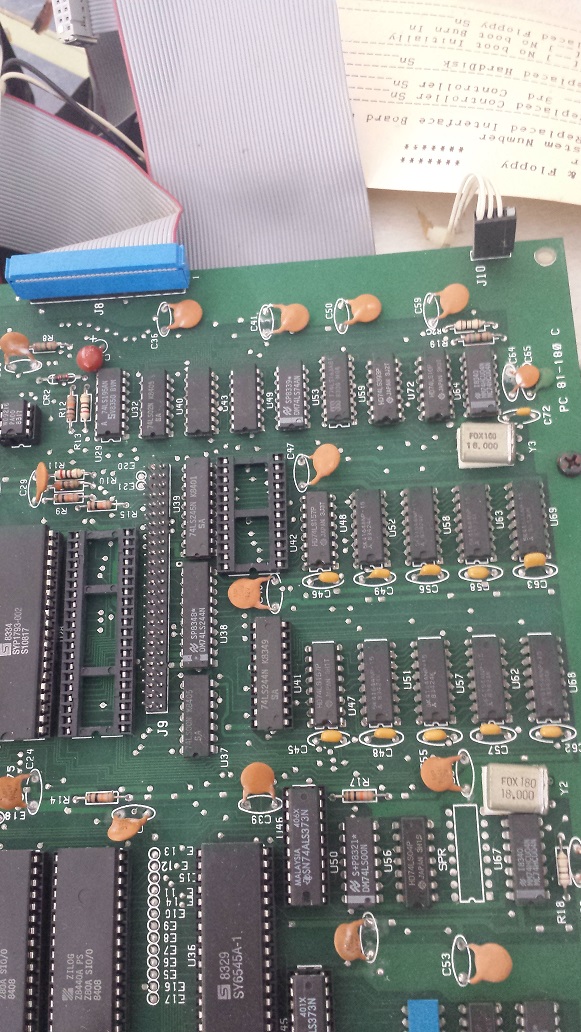

one think i noticed was the WD Hdd controller is on the side of the FDD unit..

Postby LS120 on Mon Apr 15, 2019 5:15 pm
as i said the keyboard plug on keyboard needs fixing..

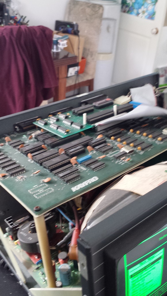

Postby LS120 on Mon Apr 15, 2019 5:17 pm

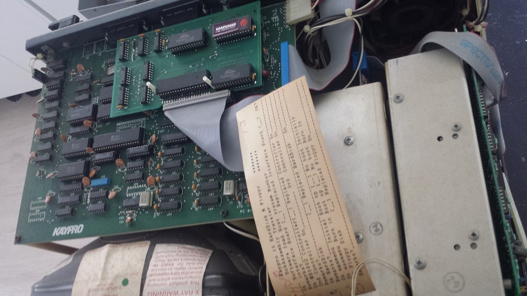

the add on HandyMan card goes into the cpu socket and the z80 into the card with the HandyMan roms..

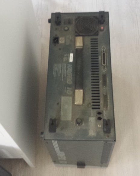

one thing i noticed is it didn't have the battery or modem built in.. but has an empty rom socket..

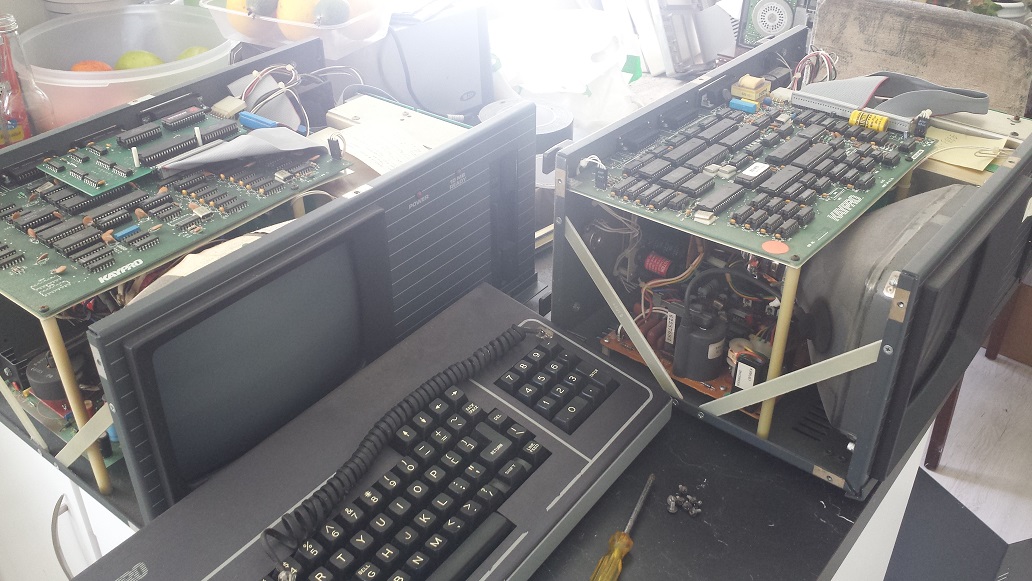

Postby LS120 on Mon Apr 15, 2019 5:25 pm
well that's different.. so both Kaypro-10's but different boards and one has the modem and battery backup the other not.. also one is all socket chips and the other soldered 90% ...need to see what one is better..
Re: Kaypro 10
Postby LS120 on Mon Apr 15, 2019 5:27 pm
the two kids side by side.. before the psu's were removed..

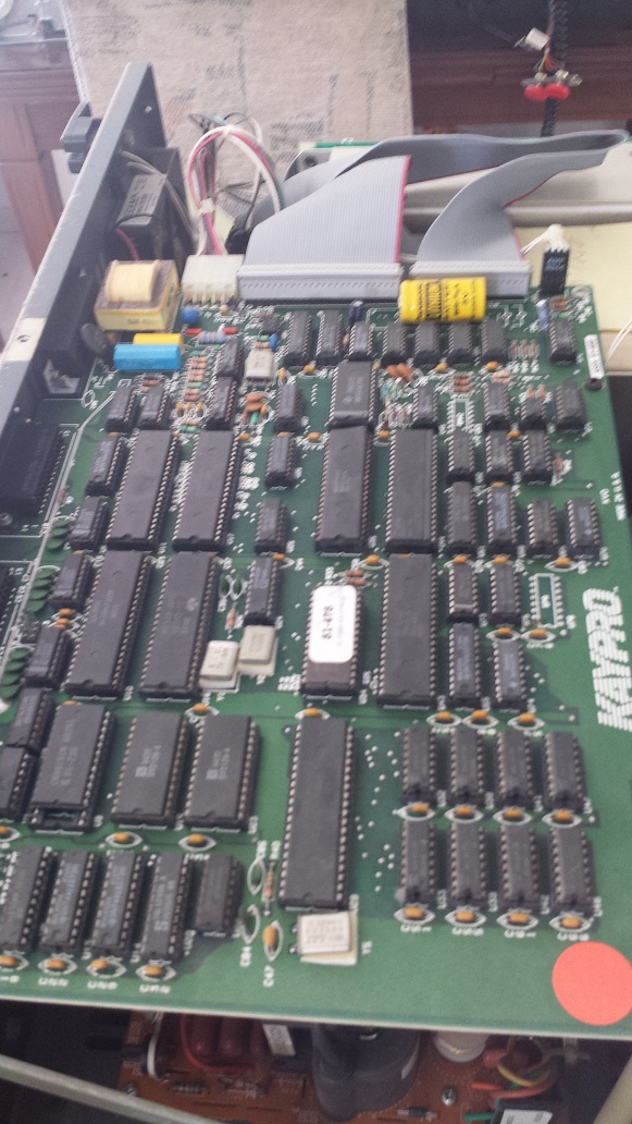

Postby LS120 on Wed Apr 17, 2019 12:39 pm
OK so looking at the 2 Kaypro-10 i seem to that a 10/83 and a 10/84 or (universal) the one thing that got me was the 10/83 still had the small rom socket but no rom in it.. then i noticed reading how to upgrade the rom to the new 28pin for the 64k roms that the HandyMan took over the roll of boot rom and has 2 x 64k srams on it as well as the Z80 with through pins...
but other than pics of the handyman no other info can i find on the net.. other than articles on it (selling adds) of the time.. so ill have to image the disks and look at the txt/doc files on the disks i have..

ok so after a week of other work that pays bills and not.. i had some more time to work on the PSU's on the K10's. after a recap of both i re-assembled the 10/83 with the handyman add on and ....... tadaaaaaaaaaaaaa Nothing at all..... what the..... so swapped the other one in and taaaadaaaaaaaa nothing... whats going on here???? so after checking and re-checking couldn't see anything. hmmm lots of head scratching and re-flowing later they both were still dead.. no 12v or 5v but the ac fan works... so must be the psu... so thinking i remembered the kp2 still works and has the same psu in it.. so remove the psu and thats when i saw it.. the 250v caps 1 was miss labled and is backwards.. so de-soldered the 1 cap and re-soldered and bingo all was go again.. looking back on it at the time i replaced them i did question if it was the right way round but well they did mark it that way round.. i was just luck i had one working to check with..

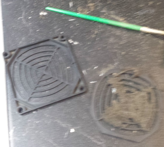

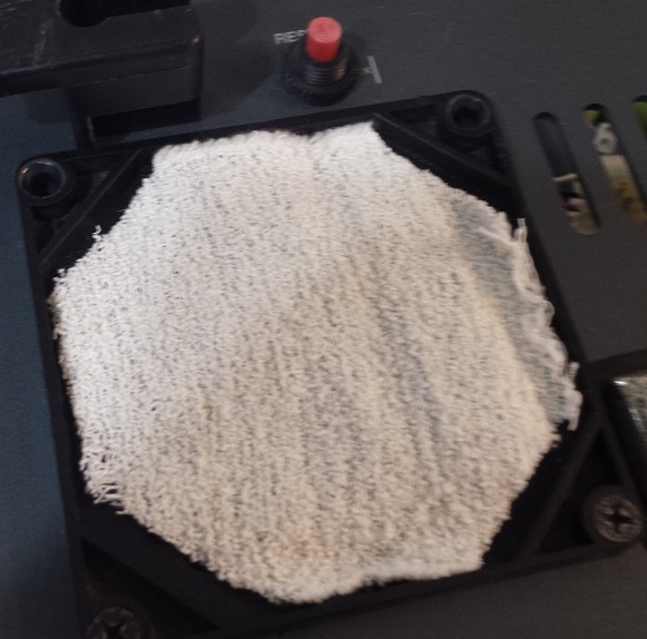

one thing i noticed was the the foam pad in the fan as just about not there and replaced with some crape bandage (thicker type) as the fan needs to have the air flow and i didn't have any foam that thin to replace it with.
Re: Kaypro 10
Postby LS120 on Tue May 14, 2019 6:49 pm
so out with the old and in with the new...
