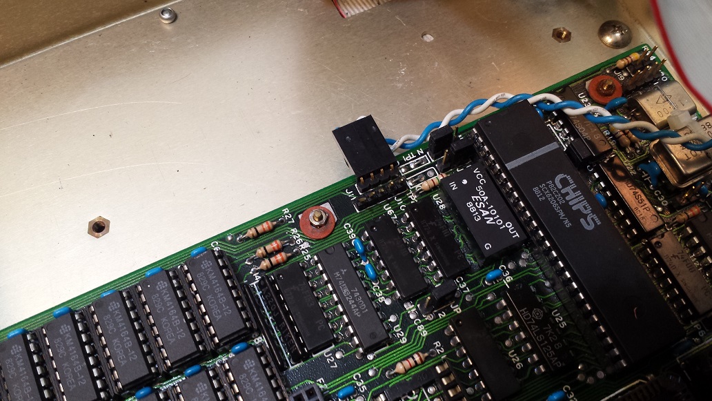

installed the card and put the plasma on to the card and set to plasma on back of card. but dont know what goes where on the card..

plugged it all together and power it on all good no smoke get a bios beep because i don't have keyboard plugged in.. so check screen and nothing.. power down and re-seated the card and check plugs.. and test again.. still nothing on screen. tested the 3 voltages going to the card and all are in spec.. so i will have to do some head scratching.. i even tried the other video card and still nothing.

ok so have had some time to look this over to find out whats going on.. and found i think whats the fault... maybe.. a +5 volt lead was lose (2 were crimped together) and one popped out when testing voltages out off the psu plug. well it seems to work now... lol (wires circled in green)
