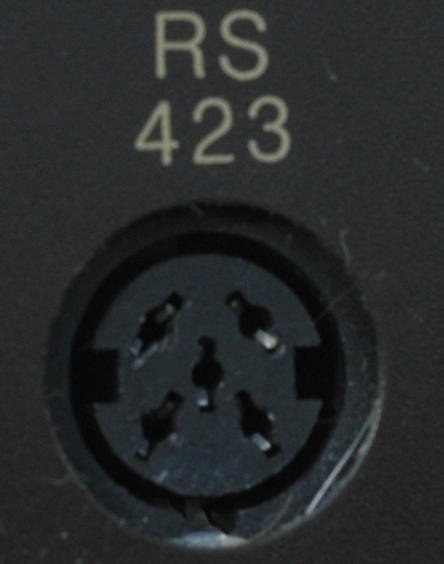

Anyone know where to get domino type 5 pin din plugs?
Cheers, Matt.

by LS120
take i pic of plug i think i may have one..

by mds_vcf
:D
