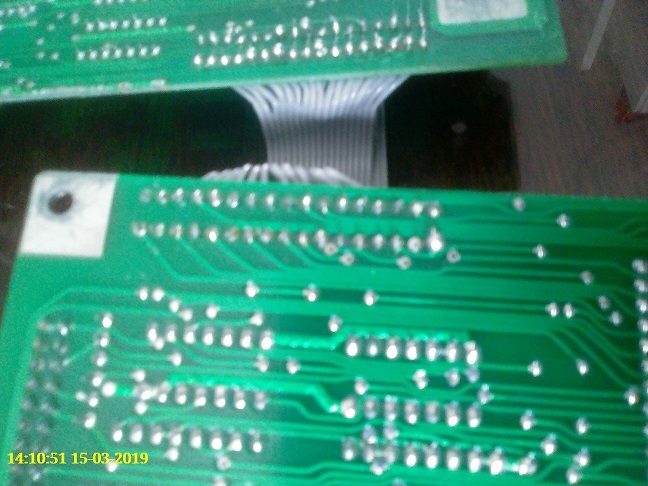

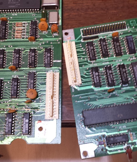

ok so had some time to check PSU out and who made these cases for the PSU... had to cut the spot welds out to get it open... well after all that it was ok..
so went and looked at boards and cables... could not see anything so unpluged hdd to see if it was ab PSU load thing making it drop voltage.. nope still not

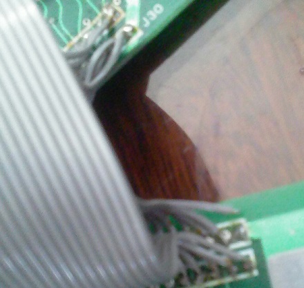

booting the fdd... so removed the motherboard with hdd/fdd board thats attached.. and what a mess ..... under the board the soldering was not good.. so
who every did this realy should have got someone whom knows what they are doing to do it... solder blobs every where, the hadd arached the rybbon cable
with small wires in the through holes and soldered the rybbon cable on top of pcb on both sides.. well after a few hours of swearing and desoldering and cleaning
out desolder pump of solder.. i had only 1 trace to repair.. i have ordered some single row locing plugs and headers to make it so you can un-plug the cable..
so waiting on those as well now.. i did find a broken wire before i desoldered the cable and that was why i did it as the rybbon cable is so easy to break..

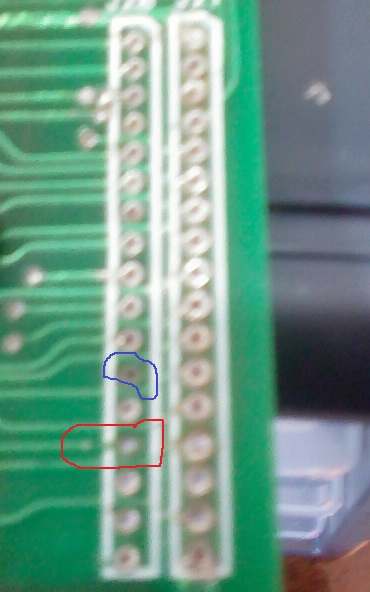

Postby LS120 on Sat Mar 16, 2019 9:44 am
i need to ge a better phone camara.. the red is lost track the blue is a non conection pin
Postby LS120 on Sat Mar 16, 2019 9:46 am
under the boards.. have newer phone now so will see how it goes..

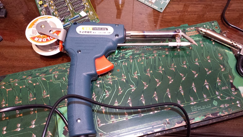

Postby LS120 on Sun Mar 17, 2019 8:59 pm
so still waiting for parts to do the 2 bondwells so decided to show the new toys i got 1 i got a month back the other i got 2 days ago and i wish i had
got one years ago.. makes life soooo much easer.. cost $17 nz
solder iron with auto feed solder

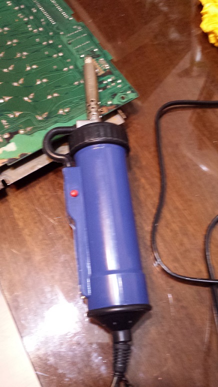

Postby LS120 on Sun Mar 17, 2019 9:00 pm
the new toy... what a dream to use. cost $28 +p&p
Postby LS120 on Sun Mar 17, 2019 9:01 pm
so easy took about 20 mins to de-solder...
Postby acsi on Mon Mar 18, 2019 9:01 pm
I had one of those desolder tools. Was great for awhile but then nearly blew up in my hand :shock:
I suggest caution with it.
Postby LS120 on Tue Mar 19, 2019 7:25 am
yes you would have to watch how long you hold the button in fo as it is a diafram design and the coils will heat up.. but other than that its working a treat..

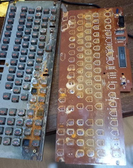

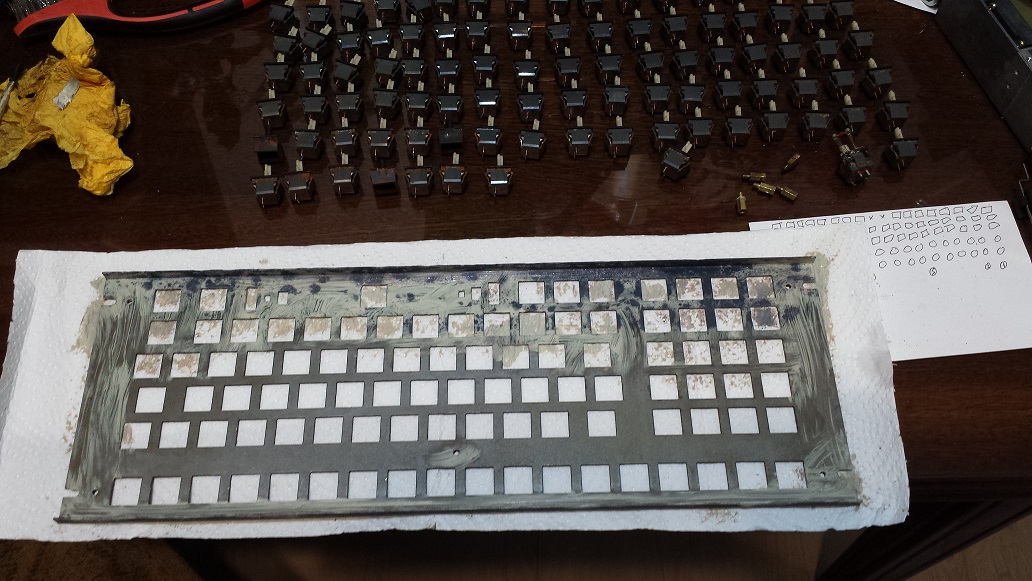

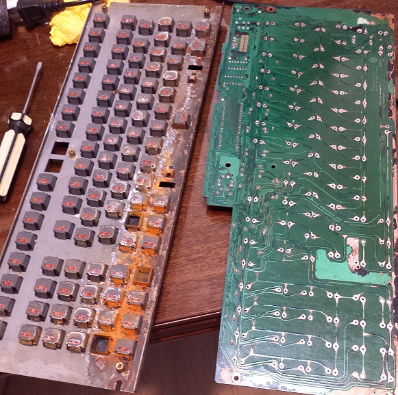

well i looked at the BW-14 keyboard and wondered how easy it would be to open to check the keys as it had rust on the metal former... so de-soldered them.
well that was easy... opening it up i found a mess in there and set to cleanning it up and removing the rust then treating it.
Postby LS120 on Tue Mar 19, 2019 7:27 am
easy to take apart after de-soldering
Postby LS120 on Tue Mar 19, 2019 7:29 am
cleanded up the metal with rust converter.. next tp paint it black again. next is to check each switch to see if any are faulty..

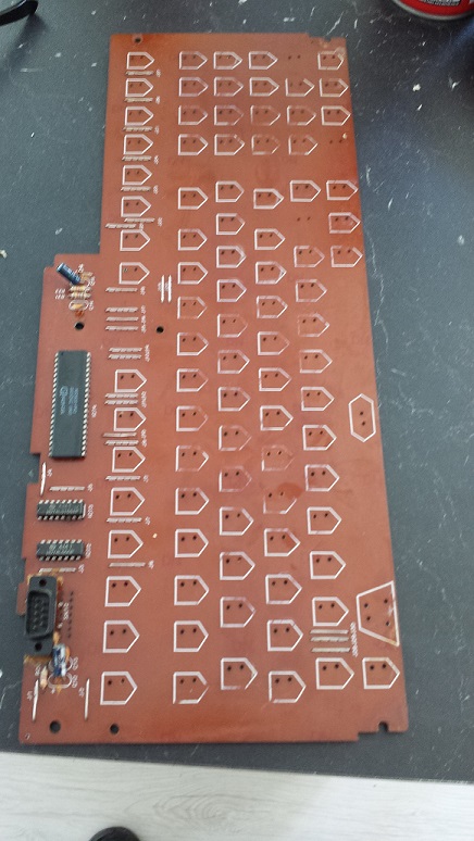

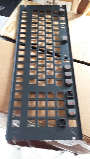

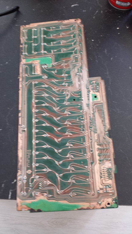

Postby LS120 on Tue Mar 19, 2019 9:41 pm
well things are moving along well.. i have cleaned up the keyboard and metal frame.. but have found some keys are not making contact..
if anyone has an old Bondwell keyboard...
well heres the updates...
Postby LS120 on Tue Mar 19, 2019 9:42 pm
top keyboard
frame... as you can see in the above pic the top right switch is one thats not working and also the caps-loc key at the moment.. still need to check the others..

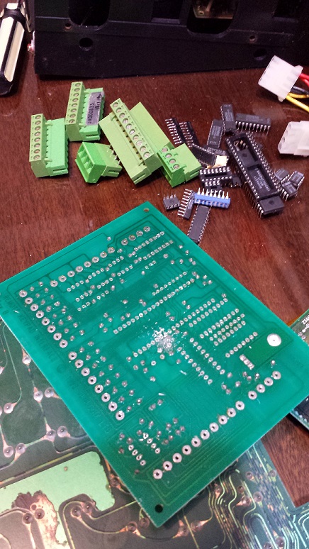

Postby LS120 on Sat Mar 30, 2019 7:38 pm
well sorry for the wait but had connectors comming from china.. they arived today and so if did some work on the Bondwell-16, and now this is better than what was there before..
