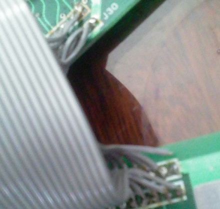

ok so had some time to check PSU out and who made these cases for the PSU... had to cut the spot welds out to get it open... well after all that it was ok..
so went and looked at boards and cables... could not see anything so unpluged hdd to see if it was ab PSU load thing making it drop voltage.. nope still not
booting the fdd... so removed the motherboard with hdd/fdd board thats attached.. and what a mess ..... under the board the soldering was not good.. so
who every did this realy should have got someone whom knows what they are doing to do it... solder blobs every where, the hadd arached the rybbon cable
with small wires in the through holes and soldered the rybbon cable on top of pcb on both sides.. well after a few hours of swearing and desoldering and cleaning
out desolder pump of solder.. i had only 1 trace to repair.. i have ordered some single row locing plugs and headers to make it so you can un-plug the cable..
so waiting on those as well now.. i did find a broken wire before i desoldered the cable and that was why i did it as the rybbon cable is so easy to break..

by LS120 » Sat Mar 16, 2019 9:44 am
i need to ge a better phone camara.. the red is lost track the blue is a non conection pin
by LS120 » Sat Mar 16, 2019 9:46 am
under the boards.. have newer phone now so will see how it goes..
